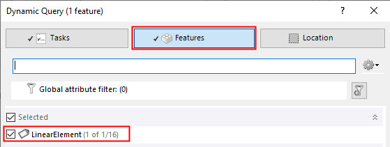

LinearElement
The export needs to include the reference alignment, so we must include the feature LinearElement.

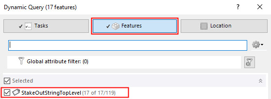

Example 1
To only add the stringlines for the road surface, then select the feature type StakeOutStringTopLevel.

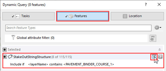

To only add the stringlines for Binder course 1, then:
  1. Select the feature type StakeOutStringStructure
  2. Filter based on the attribute layerName that contains PAVEMENT_BINDER_COURSE_1

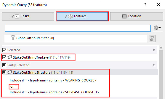

Example 4
To only add the stringlines for the road surface in addition to 2 pavement layers (f.ex. 'Wearing course' and 'Sub-base course 1'), then:
  1. Select the feature type StakeOutStringTopLevel
  2. Select the feature type StakeOutStringStructure
    1. Filter based on the attribute layerName that contains PAVEMENT_WEARING_COURSE
    2. Filter based on the attribute layerName that contains PAVEMENT_SUB-BASE_COURSE_1
Make sure to use an OR-operator for the two filters.
