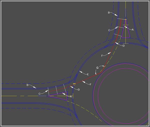

Entry Angles
Entry angle and 'Deflection' are the two main ways to check the 2D design of a roundabout. All roundabouts must adhere to the rules of these parameters.
  • Mark the check box to have them drawn.
Calculation of Entry Angle
  • Draw 3 perpendicular lines from the deflection island (kerbstone) to shoulder line as shown in the illustration
  • Draw an arc through the mid-points of these 3 lines and extend it to meet the inscribed circle (see the illustration)
  • Draw a tangent to this arc at the intersection point with the inscribed circle (see the illustration)
  • Similarly, obtain the tangent to the exit road
  • Entry angle is given by [90-(θ/2)], where θ is the included angle of the tangents (see the illustration)
  • The entry angle should be as per the road standards
A= Deflection Island B= Kerb line
C= Perpendicular lines D= Arc through the mid-points of the perpendicular lines
E= Inscribed circle (extend the arc) F= Tangent line to the arc
G= Included angle (θ)
