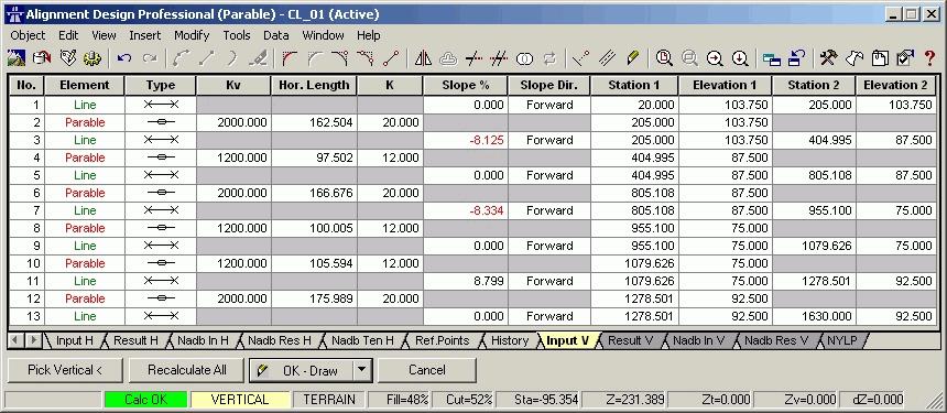

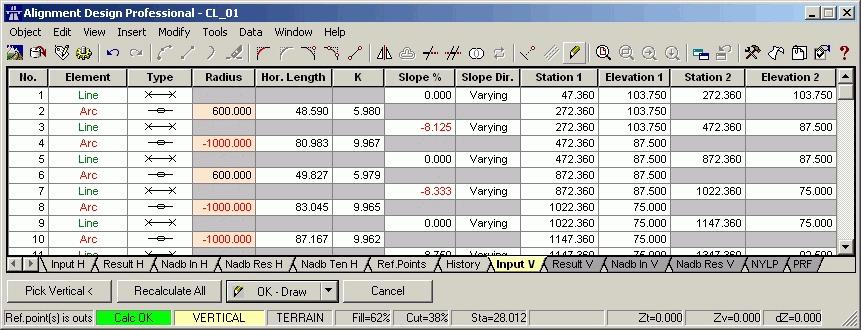

  • The table 'Input V' of the user interfaces will be having an additional column for 'K - Value'.
  • Define the 'K - Value' in the cells of curve elements of the column 'K'.
  • The values, Radius/Kv, Horizontal Length, and K are interrelated and if, one of these values is edited, other values will be updated automatically.
Figure: User Interface for Circular Curves
Figure: User Interface for Parabolic Curves

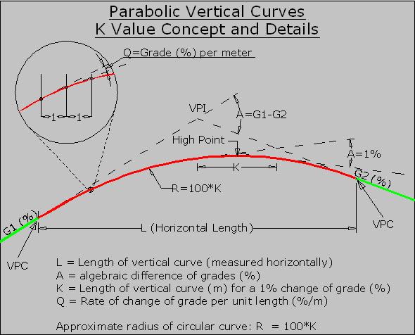

K - Value concept
  • For a simple parabola, the rate of change of grade per unit length (horizontal) of the curve is a constant 'Q', and is equal to the algebraic difference between intersecting tangent grades (%) divided by the length of the curve in meters; expressed as: Q = A/L in percent per meter.
  • The reciprocal K is defined as the horizontal distance in meters which results in a 1% change in grade: K = L/A
  • The reciprocal L/A, termed 'K', is the horizontal distance in meter required to make1% change in gradient and is, therefore, a measure of curvature.
  • The quantity K is useful in determining the horizontal distance from the vertical point of curvature (VPC) to the high point (in case of the summit) curves or the low point (in case of sag curves). This point where the slope is zero occurs at a distance from the VPC equal to K times the approach gradient.
A= Length of the Curve (measured horizontally) B= Algebraic difference of Grades (%)
C= Length of the vertical curve (m) for 1% change of grade (%) D= Rate of change of grade per unit length (% per meter)
E= The approximate radius of circular cure (R) = 100*K F= Vertical Point of Curvature (VPC)
G= Vertical Point of Intersection (VPI) H= High Point
  • For simplicity, a parabolic curve with an equivalent vertical axis centered on the vertical point of intersection (VPI) is usually used in roadway profile design.
  • The vertical offset from the tangent varies as the square of the horizontal distance from the curve end (point of tangency).
  • The vertical offset from the tangent grade at any point along the curve is calculated as a proportion of the vertical offset at the VPI, which is AL/800, where the symbols are shown in the above figure.
  • For each design speed and sight distance configuration, a single value of K defines the length of the curve L for all values of A.
  • Also, for design purposes; a vertical curve can be plotted using a circular curve of radius R, which is approximately very close to a parabolic curve by the relationship: R = 100*K.
