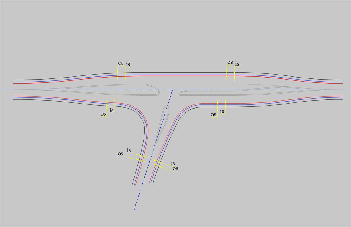

Edge lines
Use this button to define the shoulder widths of all the joining roads at the intersection.
  • Shoulder/pedestrian path width and offset of curb from road edge can be defined for all the lanes.
  • The unit of linear measurement is meters and angular measurement is decimal degrees.
  • The interface is in accordance with default driving lane setup, right lane driving for International installation of Novapoint.
  • Different shoulder widths for different traffic lanes can be defined.
From the major to minor road
  • Inner shoulder (is): Defines the offset of the outer shoulder from the road edge
  • Outer shoulder major road (os): Defines the width of the outer shoulder for the road
From minor to major road
Outer major road
  • Inner shoulder (is): Defines the offset of outer shoulder from the road edge of major road
  • Outer shoulder major road (os): Defines the width of the outer shoulder for the major road
Standard Values
Press this button to reset all parameters to the default value.
Example of edge line parameters

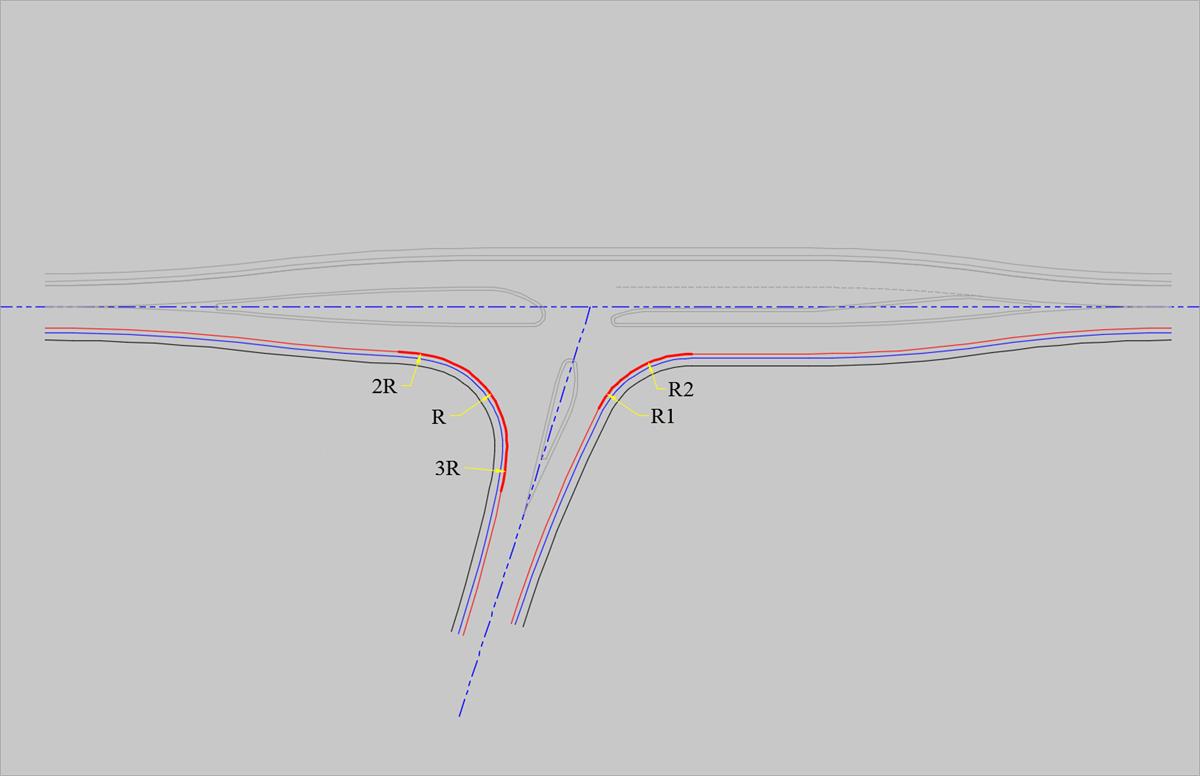

Smooth corners
Use this button to define the edge line radius of the road lines at the intersection.
  • Defines the type of curves for edge lines from major to minor roads and the radius
  • The interface is in accordance with the default driving lane setup (right lane driving for International installation of Novapoint).
Corner radius
  • Defines separate settings for the vehicles diverging from major to minor road and the vehicles diverging from minor to major road
  • The program handles three different types of curves as an edge line
  • Mark the desired type of curve and define the radius
  • Simple curve (R): Curve with one arc element. Define the radius
  • Double curve (R1-R2): Curve with two arc elements. Define the radius for both arcs
  • Compound Curve (2R-R-3R): Curve with three arc elements. Define the radius for the central arc element. Radius for the other arc elements is by default defined as two times and three times that of the central arc element. The user can type in other parameters.
Example of smooth corners parameters

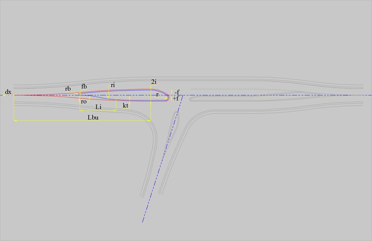

Traffic separator
A traffic separator is a divider designed for road arm 'A'. For further details, refer to the topic 'Traffic separator'.
  • All the parameters related to the median can be defined in this dialog.
  • The explanation text below is in accordance with the right lane driving setup.
Parameters
  • Maximum width (2i): Defines the width of the median
  • Length of widening (Lbu): Defines the length of the approach for the median
  • Turning radius (Rsl): Define the turn radius
    • The parameter is related to the function 'Island' of road arm B.
    • If the object'Island' of road arm B is selected, this parameter will be disabled as the program calculates the value for turning radius from the parameters defined for 'Island'.
  • Front radius ( r): Defines the radius for the front rounded edge of the median
  • Displacement from centreline (+/-f): Define the displacement (across the carriageway) of the median (front part) from the centreline
  • Displacement from intersection (dx): Define the displacement of the whole median away from the intersection of minor and major road centrelines
Kerb
  • All the parameters related to the Kerb of the traffic separator can be defined in this dialog.
  • The interface is in accordance with default driving lane setup (right lane driving for International installation of Novapoint)
Parameters
  • Distance road marking - kerb (kt): Defines the offset from the road edge and the kerb
  • Radius rare circle (rb): Defines the radius of the rare edge of the curb. The length of the curb will be adjusted within the length of the traffic separator based on this radius
  • Displacement rare circle (fb): Defines the displacement of the rare edge of the kerb from the centreline
  • Taper length (Li): Defines the length of the taper portion of the curb.
  • Radius taper (ri): Defines the radius for taper
  • Radius taper transition (ro): Defines the radius of transition from taper to straight
Standard values
Press this button to reset all parameters to default values.
Example of Traffic separator and curb parameters

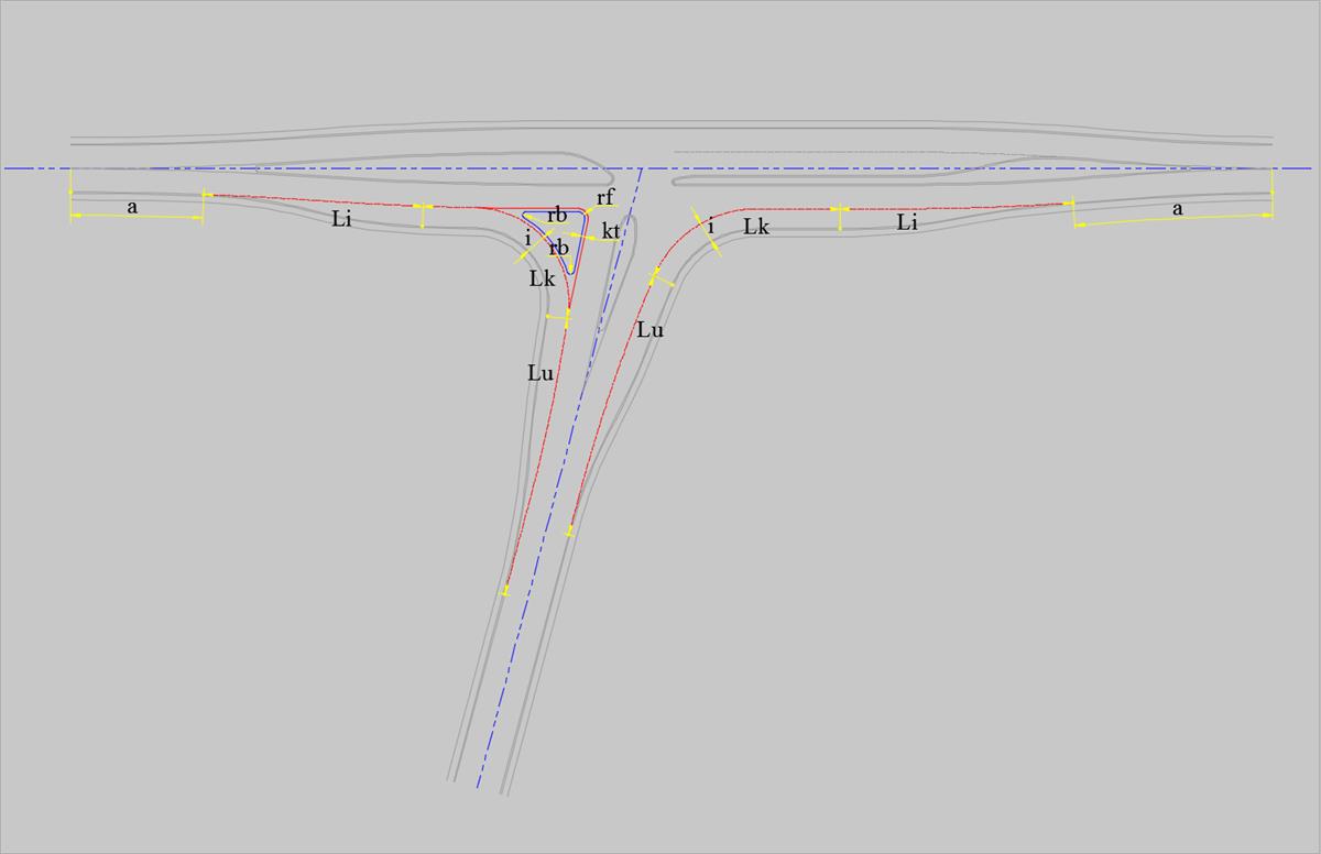

Right turn lane
The right turn lane is an extra lane designed for the vehicles diverging from one road arm to other with a right turn. For further details, refer to the topic 'Right turn lane'.
  • All the parameters related to the right turn lane can be defined in this dialog.
Right turning lane and/or weaving lane
The right turn lane is the extra lane provided for vehicles diverging from one road arm to the other with a right turn. The right turn lane can be designed in three different types.
  • Right turn lane only: This type will have an extra lane, only for the current road arm.
  • Right turn lane and weaving lane: This type will have an extra lane from both road arms.
  • Weaving lane only: This type will have an extra lane, only for the road arm the right turn leads to.
Depending on the type selected some of the parameters will be disabled. For the type Right turn lane and Weaving lane, all the parameters will be available. The following text explains the option 'Right turn lane and Weaving lane'
  • Distance approach island (a): Defines the distance from the rear end of the traffic separator of the current road arm to the start of the right turn lane on the current road arm
  • Maximum widening (lane width) (i): Defines the width of the extra lane
  • Taper length out (direction of travel (Lu): Defines the transition length required for shifting the vehicles to the extra lane
  • Length with constant width (Lk): Defines the length of the extra lane with constant width
  • Taper length in (direction of travel (Li): Defines the transition length required for shifting the vehicles to the extra lane
Three Corner Island
In addition to the extra lane, a three-corner road island can also be designed
  • Distance road marking kerb (kt): Defines the distance of the three-corner road island edge from the road edge
  • Radius towards the junction (rf): Defines the radius for the rounded edge provided to the road island at its front portion
  • Corner radius (rb): Defines the radius for the rounded edge provided to the road island at its rear ends
Standard values
Example Right Turn Lane

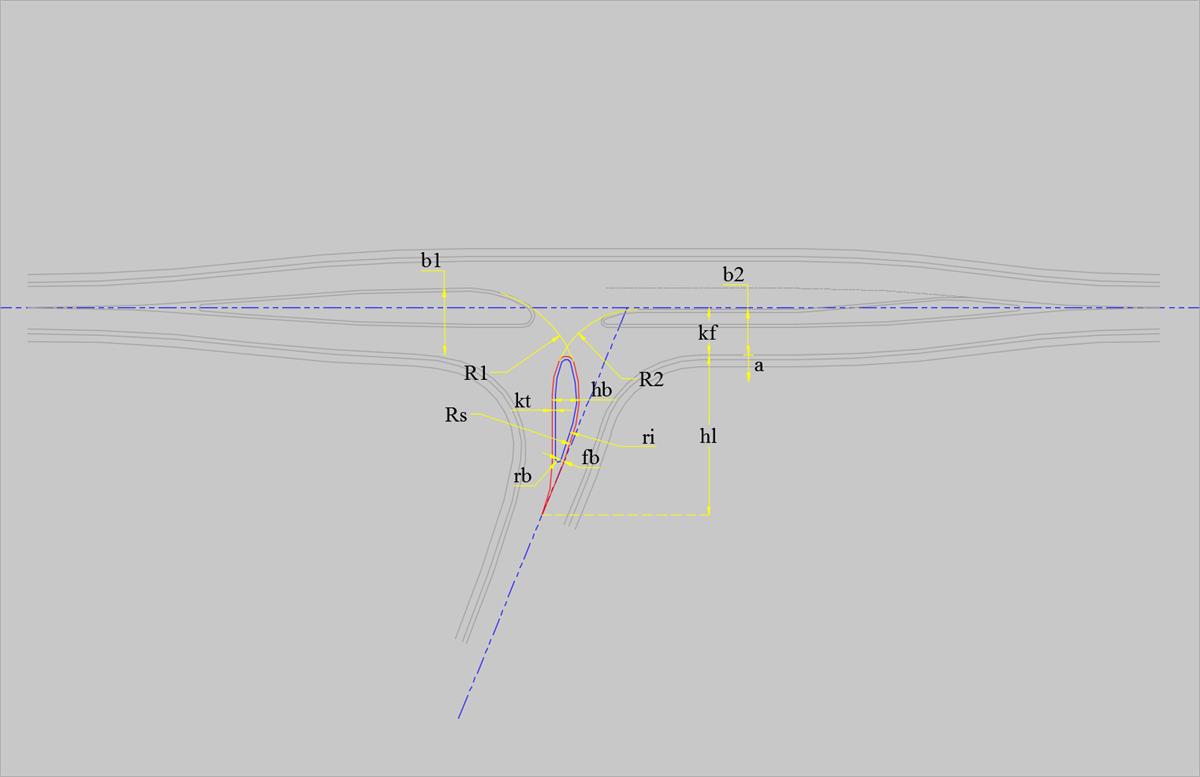

Island
Road Island is a deflection island on road arm 'B'. For further details, refer to the topic 'Island'.
  • All the parameters related to the deflection island can be defined in this dialog.
Deflection Island
  • Width Deflection Island (hb): Defines the width of the Deflection Island
  • Length Deflection Island (hl): Defines the length of the Deflection Island
  • Curvature Deflection Island (Rs): Defines the radius for Deflection Island
  • Increased distance from major road (+/- a): Defines the set back of the deflection island from the road edge of major road
Kerb
  • All parameters related to the Kerb of the deflection island can be defined in this dialog
  • Distance road marking Kerb (kt): Defines the offset of the road edge from the kerb
  • Radius rear circle (rb): Defines the radius of the rounded edge provided to the deflection island at its rear end
  • Displacement rear circle (fb): Defines the displacement of the rear end of the deflection island away from the centreline
  • Radius taper (ri): Defines the radius of the taper. The parameter reflects if the angle of intersection is other than 90°.
Standard values
Example Island parameters
Left turn separator
The left turn lane is an extra lane designed for the vehicles diverging from one road arm to another with a left turn.
  • All parameters related to the left turn lane can be defined in this dialog
  • A traffic separator can also be designed
  • Width median (a): Defines the width of the traffic separator
  • Width left turn lane (b): Defines the width of the extra lane
  • Length of widening (Lbu): Defines the length of approach for the intersection
  • Taper length (Lki): Defines the transition length required for shifting the vehicles to the extra lane
  • Braking distance (Ld): Defines the stopping distance for the vehicles
  • Queue Length (LkØ): Defines the length of the road required to house the vehicles waiting for a left turn
  • Taper radius (Rki): Defines the radius for the tapered element designed at taper length
  • Front radius ( r): Defines the radius of the rounded edge of the traffic separator at its front end
  • Displacement from centreline (+/- f): Defines the displacement of the front end of the median from the centreline
  • Displacement from intersection (dx): Defines the displacement of the whole traffic separator away from the intersection in the direction primary road
Kerb
  • All the parameters related to the Kerb of the left turn lane are defined in this dialog.
  • Distance road marking curb (kt): Defines the offset from the road edge and the curb
  • Radius front circle (rf): Defines the radius of the rounded edge provided at its front end
  • Radius rare circle (rb): Defines the radius of the rounded edge provided at is back end. The length of the kerb will be adjusted with the length of the left turn lane based on this radius
  • Displacement rare circle (fb): Defines the displacement of the back edge of the kerb from the centreline
Standard values
Press this button to reset all parameter values.
Example Left turn separator
