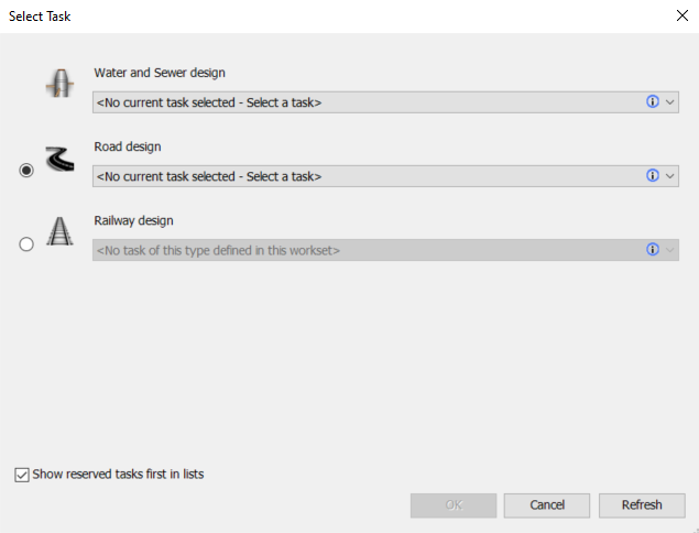

We can now open the WS task in a Cad-program and start to work in the WS module:
  1. Open Task in the WS module to connect
  2. Under Water and sewer design in the dialog, select the correct task
  3. You can also include a road model
  4. End with OK
