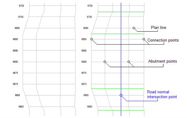

The tunnel grid in the geology editing window consists of horizontal folded-out perimeters, with 5 meters between them, and 4 vertical lines representing the connection points between the perimeter and the road base (the outer left and right lines), and the abutment points (where the perimeter tangent is at 45 degrees angle to the road surface. We call such a fold-out perimeter a “plan line”.
The plan line can be thought of as a measuring tape being extended along the periphery of the actual perimeter from one connection point to the other. The abutment points are ticked off on the measuring tape along with the road normal intersection, and the measuring tape is then stretched out and placed flat on a sheet of paper.
The road normal intersection point is then considered to be the origin of the measuring tape. All points to the left of this point are negative, all points to the right are positive. These values are considered to be the X coordinate of the tunnel grid. The chainage number is considered to be the Y coordinate.
A point halfway between the abutment points is ticked off, and we call this the midpoint of the plan line. Note that the midpoint and the road normal intersection point may be at the same position, but not necessarily so. The midpoint does not play an important role in creating the tunnel grid.
The left figure shows the tunnel grid as it is drawn on the screen. In the right figure, the blue line shows what a longitudinal line through the road's normal intersection points would have looked like. The green lines show the plan lines at “points of special interest”. Note how the longitudinal lines break at these plan lines, even though the plan lines themselves are not drawn.
