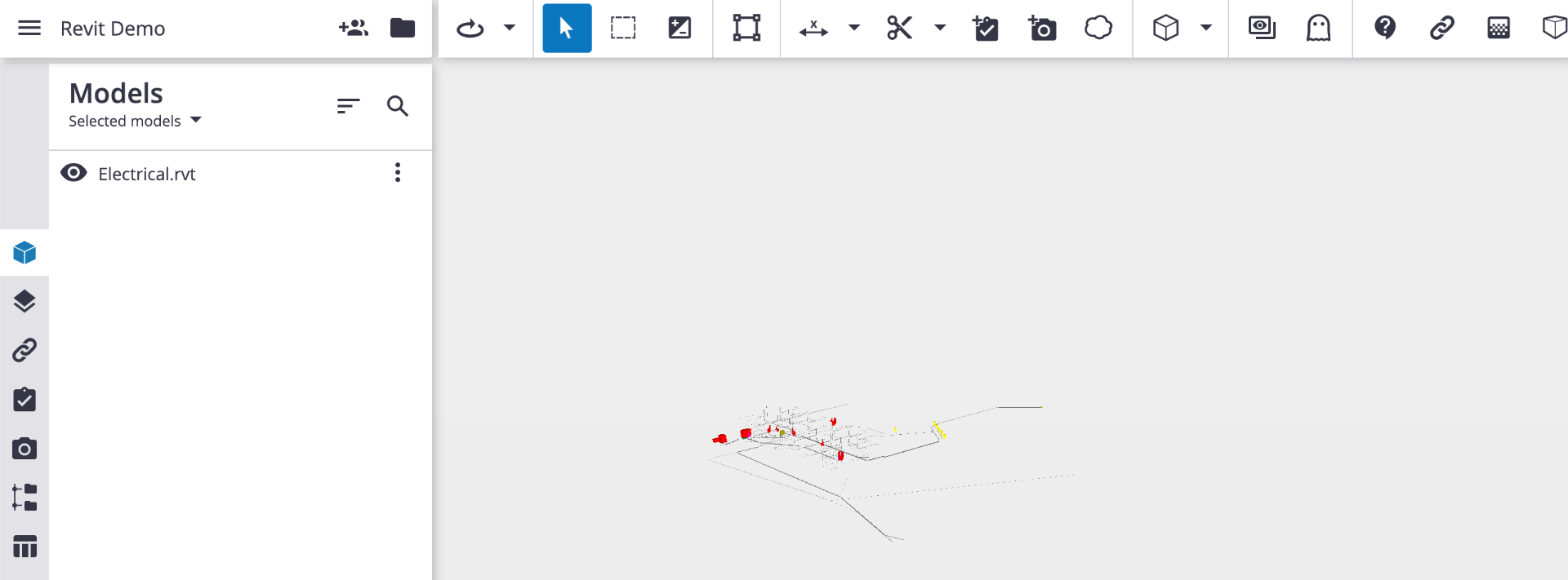

  6. Click the View button
  7. Once the file has been processed it will appear in the 3D viewer. Note that the processing result depends on the naming conventions that were used during the creation of the RVT file in the authoring application (see Important Notes)

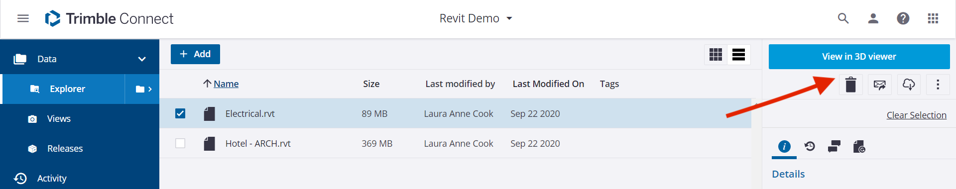

  1. Go to the Explorer page.
  2. Select a file by selecting clicking anywhere in the row
    Note: clicking the file name will open the file in the Viewer application automatically.
  3. To view the file, click the View in 3D viewer button or the model thumbnail in the Details panel on the right-side.
  4. The 3D application will open in a new tab

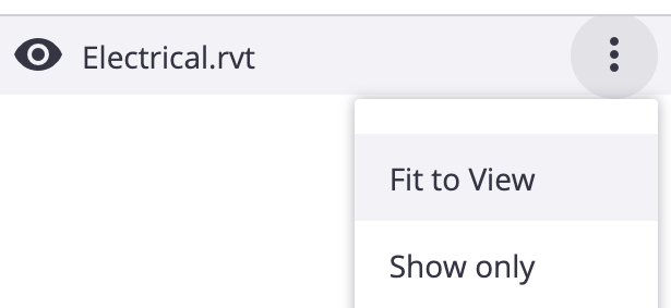

  5. Once the file conversion is complete, your model is ready to view
    Note: If the conversion is complete but you are not seeing your model, it may be because of the zoom level. In the Overflow Menu - select the option Fit to View
