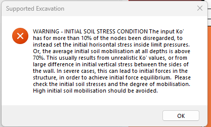

This is a warning message and not an error message.

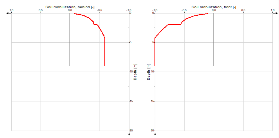

Which means that it doesn't necessarily have to be wrong in the calculation - but that it could be. The warning message says is that the user has very high initial soil mobilization (over 70% on average). It can be due to various things. Some, e.g. that you have terrain loads or vertical additional stresses behind the rafters that cause this, is ok and means that you can ignore the warning (once you have made sure that it is the load/additional stresses that are the cause). A tip is to take a look at the diagram for Soil mobilization (both with and without loads/vertical additional stresses if you have them).
There are also other reasons why you might get the warning message. Often (but not always) then high initial mobilization is due to K0' being a little too low. Normally, you try to find out why you get the warning message so you know if you can ignore it or if you should change your model.

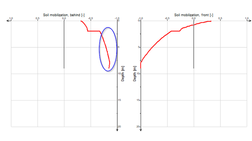

Eg. In this case, there is high initial soil mobilization from a depth of about 2 m:
Thus it is that in this case it is the off-road load that causes the warning. So then everything is ok and the user can ignore the warning.

I detta fall så är det hög initial Soil mobilization från ca 2 m djup:
(se bilderna ovan)
Därmed är det så att det i detta fall är terränglasten som orsakar varningen. Så då är allt ok och användaren kan bortse från varningen.
