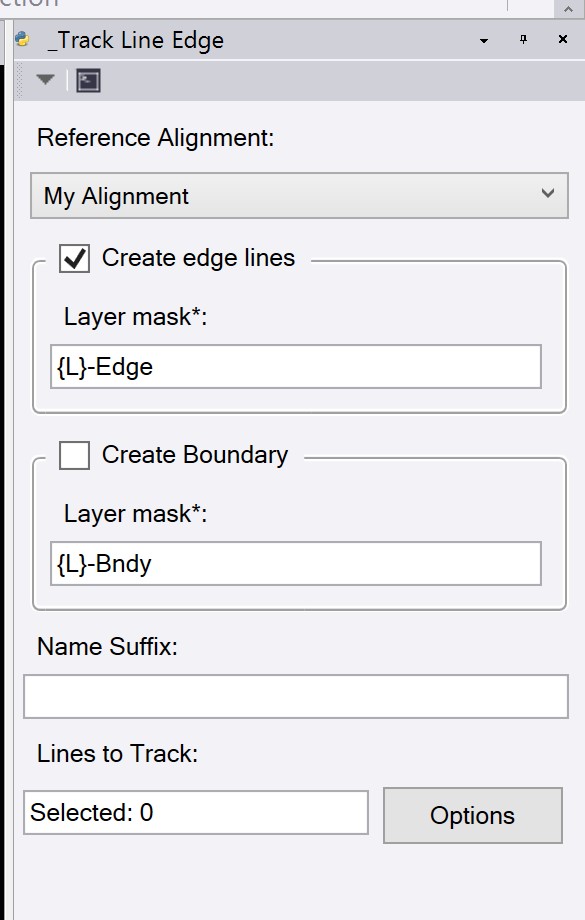

This macro can be used to connect the outside edges of linework (as computed from the selected reference alignment). Each node in every selected line has its station and offset computed. The min and max offset values at each computed station is then used to create a linestring connecting the edges.
This is usually used to connect 3D cross-section linework in order to produce surface models.
