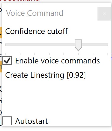

When the command starts up, you should see a small window that defines the command options.
The slider can be used to specify how close to a match the voice command needs to be in order to execute the command. The default is 0.80 (80 percent). Only matches higher than this tolerance will be executed.
If you want to disable the voice recognition but leave the command running, you can uncheck the "Enable voice commands"  checkbox.
If the "AutoStart" checkbox is "checked", then the macro will start when TBC starts.
If you speak a command the speech engine doesn't recognize, then you will see;
               "Rejected: [<cmd>]" in the commands window.
If you speak a command the engine matches to one of the commands in TBC, then the window shows the name of the command and the match confidence. If the confidence is greater than the match tolerance defined using the slider, then the command will be executed.
