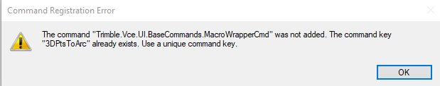

Warning: If you install the same macro in multiple folders (under the macro folder) then you will get an error when TBC starts (see image). Just delete the duplicate macro file to stop this error from occurring again.
