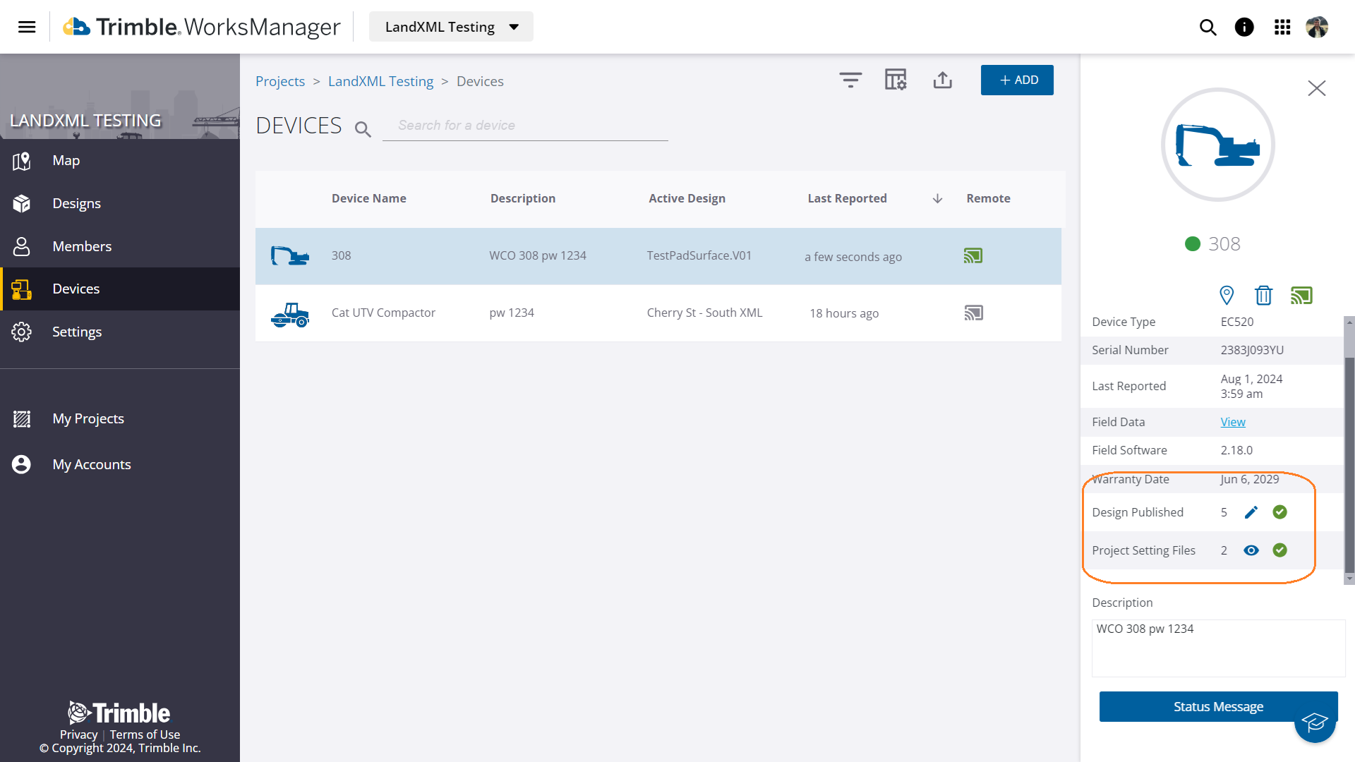

Device Connection Status Indicator.
For devices which support the enhanced communication mechanism, you can now view the connection status in the project device pane.
The project device pane can be accessed by opening a project in WorksManager, clicking devices then selecting the device you are interested in.
The indicator located next to the device name will be gray when a device is offline, and green for when the device is currently connected.

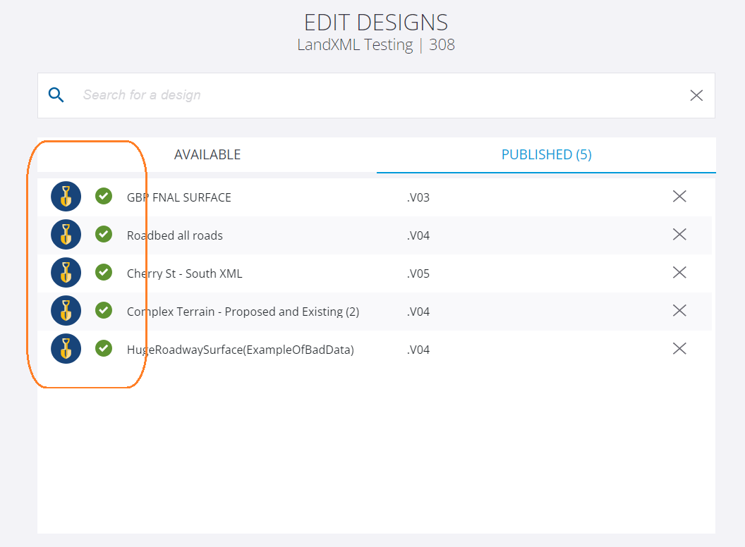

Design Status Indicator
The status of designs on a device are now visible in WorksManager in the project device pane. This at enables users to see at a glance if there are any issues which require attention.
  • A green tick indicates that the device has received and successfully processed the designs that are assigned to it.
  • A yellow exclamation mark indicates that a design is in the process of being delivered to the device.
  • A red exclamation mark indicates that a design is in error state and requires attention.
To view additional details about specific designs click the pencil icon. The edit designs screen will open. The icons next to the design indicate the state of that design.
If there are errors reported by the field system, the sync issues button will be displayed which you can click on to view the reported issue.
Project Settings
Like designs, project settings state can be accessed from the device pane.
Like with a design, click “View Sync issues” for information from the device on the issue.
