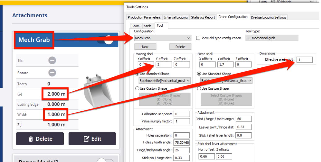

Create the attachment in the EC520 Tech UI using the normal bucket measure-up and calibration.
EC520 Measure-up

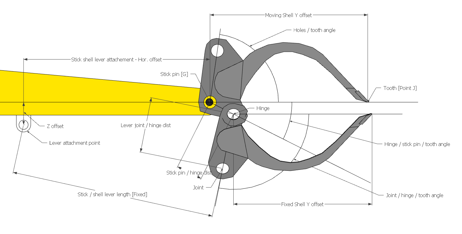

  • Point J is the tip if the ‘Moving Shell’
  • G-J is used by the EC520 driver to populate the ‘Moving Shell’ Y Offset
  • Width is used by the EC520 driver to populate the Effective Width
NOTE: These values can be edited in TMC but will be overwritten by the EC520 driver so should only be edited in the EC520 Tech UI.
