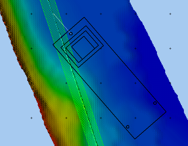

Add a 'Restricted Area' layer to the Plan View display
The cable avoidance zone (10ft either side of route) is shown on the plan view as the vessel approaches
When the spud location enters the restricted area the alarm is triggered.
