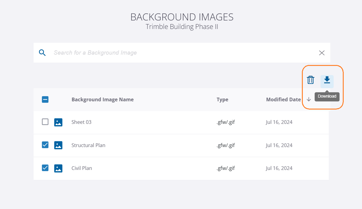

We are happy to inform that you can now download background images, either as single files or in bulk.
With this enhancement, you can now add, view, edit, delete, download background images to data collectors, both as single as well as in bulk :)

We are happy to inform that we now support adding background images in bulk from WorksManager :) You can delete the images in bulk as well. Note that the bulk limit is capped at 50 pairs of image/ world files now; if you do have more, then you can do it in batches.

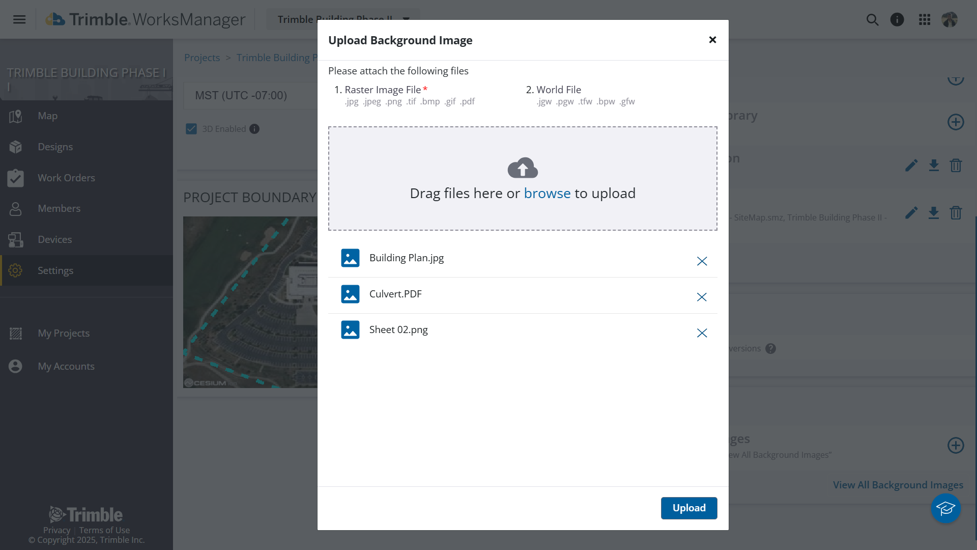

Background: Today, Siteworks can display a background map for designs. However, there is no way to publish it from the office with WorksManager.
Introducing ‘Background Images’ option in Project Settings in WorksManager. You can now publish background images to data collectors. This setting applies to all the Siteworks data collectors in the project.
1. Go to Project > Settings > ‘Data Collectors’ card
2. Add any number of background images (pairs of raster images and world files). WorksManager will publish these background images to all the  Siteworks data collectors in the project.
3. View all files with the ‘View All Background Images’ link
Key takeaway: When you add a background image from the project settings, WorksManager will publish this background image to all the Siteworks data collectors in the project.

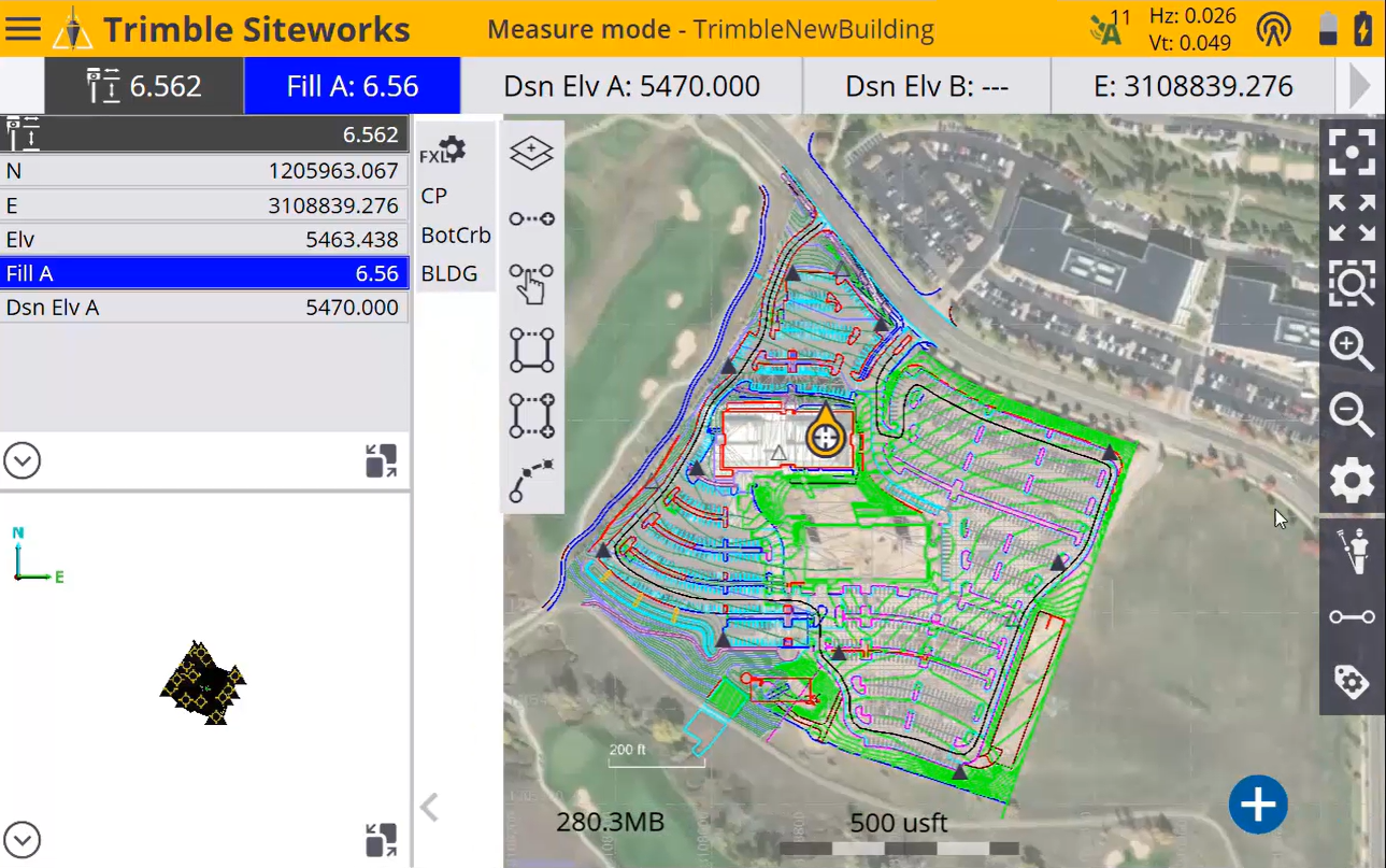

Now, in Siteworks, you can use the ‘WorksManager Sync’ to download the images from the cloud, navigate to ‘Map Display Settings’ > ‘Settings’ to toggle the background image on/ off and then load the desired image as the background.
