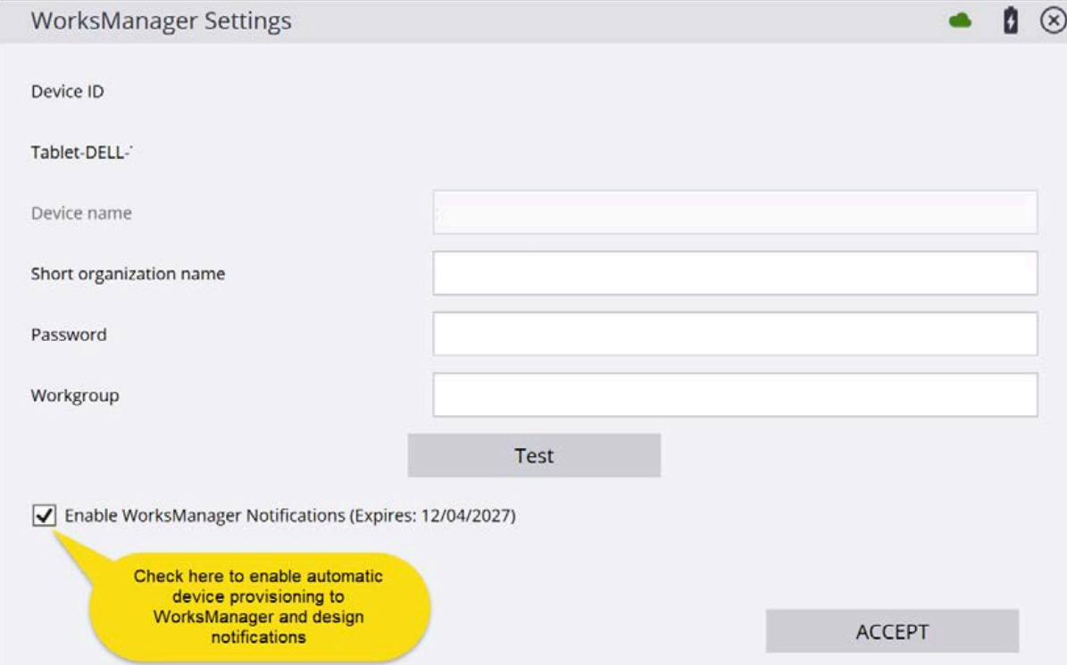

  • Install Trimble Siteworks Software v1.75 or above in the new data collector
  • Add device/ org info. in WorksManager settings screen, and check the 'Enable WorksManager Notifications' checkbox

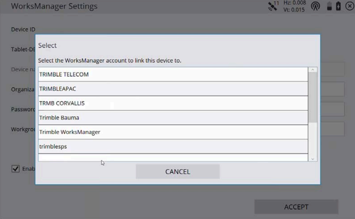

  • Login to Trimble Cloud with your TID credentials, and select the account to provision the device to (in the cloud)

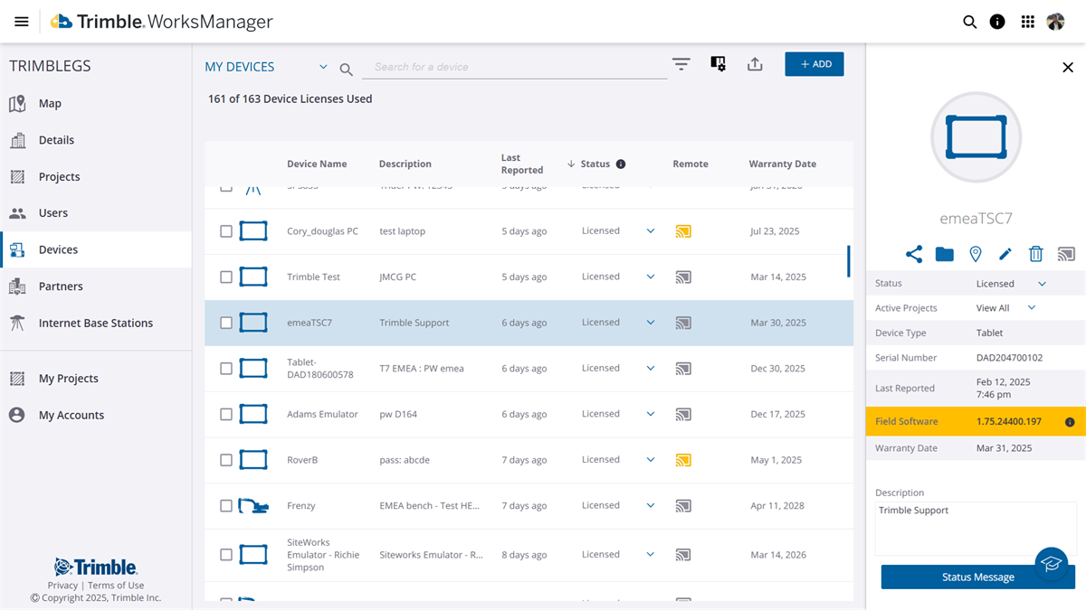

When this is done, the device will be added to the WorksManager account in the cloud, provisioned and claimed instantly. You can then view, access and interact with the device in WorksManager as usual from WorksManager Account > Devices page

  • The device information must be entered prior to tapping the “Enable WorksManager Notifications” checkbox in Siteworks settings

One other note is that in Siteworks you must enter the SHORT Organization Name, which may be different than the Organization/Account name that you select in the Popup menu after entering your TID...
You can find the Short Org name in the "Details" panel of WorksManager.
Also, if the device is already in WorksManager, you should not need to re-enter any data, and can just select the checkbox, and then pick the same Account the device is already in.
