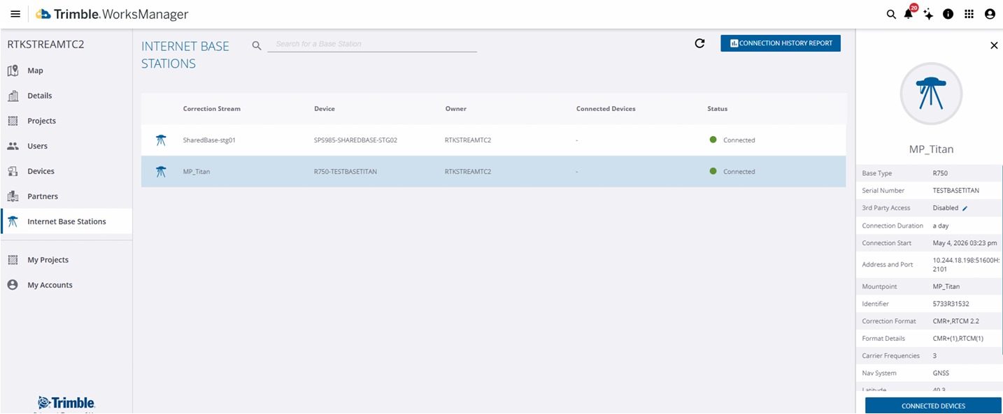

To generate shared credentials for a base station, navigate to the Internet Base Stations tab in WorksManager. Select your specific correction stream from the list to open the right-side panel. By default, you will notice that the "3rd Party Access" status is set to "Disabled".

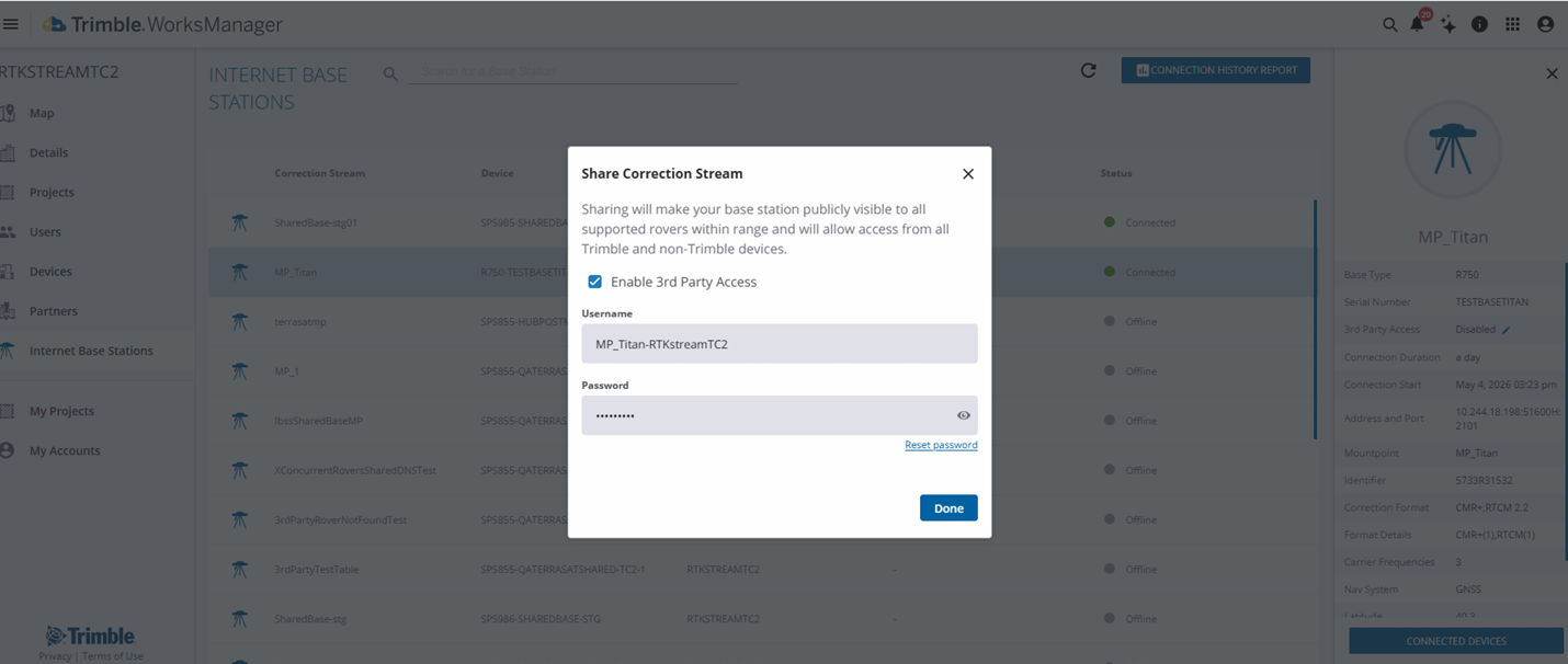

To activate it, simply click the pencil icon next to "3rd Party Access" to open the configuration window, and check the Enable 3rd Party Access box. The system will automatically generate a dedicated username for this stream. For the password, you can either allow the system to auto-generate one for you, or you can define a custom password by clicking the reset password link. Once you have your details set, click Done.
You will receive a success message confirming the setup, and the stream's status will officially change to "Enabled".

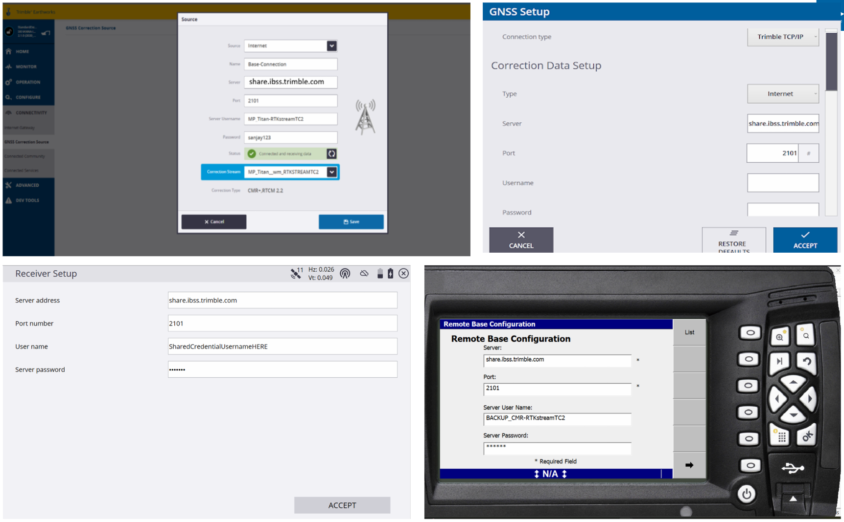

Once your shared credentials are created, connecting your field solutions is a standardized process. Across all supported systems, you will configure your receiver with the following details
  • Server URL: share.ibss.trimble.com
  • Port: 2101
  • Username & Password: The shared credentials you just generated
This configuration works seamlessly across multiple field solutions, including Trimble Earthworks, Trimble Groundworks, Trimble Siteworks, GCS900, and SiteVision. For most of these systems, such as Trimble Earthworks, you simply enter these details, select the corresponding mount point from the dropdown menu, and the base will automatically connect and begin receiving data
