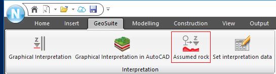

This tool, in the panel “GeoSuite”, may be used to insert interpreted points with attribute “B” from a selected termination code - normally “Assumed bedrock” or “StoneBoulder”.
The resulting interpreted point(s) will be available for building 3D model for Bedrock using the template “Rock” in the “Sub surface” tool in the “Modelling” panel.
The tool will create interpreted points with attribute “B” (Rock) for the selected “termination code”.
