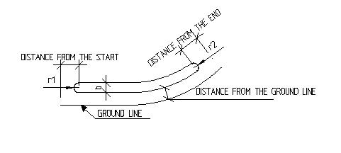

The function is used to construct a plant bed or a hedge along a line in your drawing.
MOUS_ICO Menu: Landscape > Construct Lines and Polygons > Create Polygon along a Line
MOUS_ICO Toolbar: Construct Lines and Polygons:  Create Polygon along a Line
The dialog has parameters where you can type in the desired values. The figure below gives a graphical illustration what each parameter is used for: After defining all the parameters click Ok. Command prompts for:
Select a baseline:
Select your baseline or select each element of the baseline if the baseline is not continuous. The start of your line will be decided by the first element selected. Press ENTER Pick left or right side:
Pick the side of the baseline to draw the polygon.
