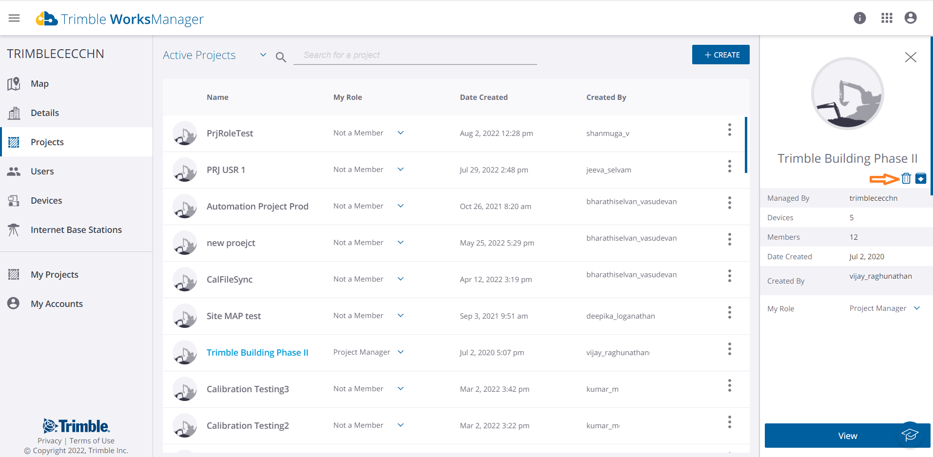

How to delete a project from WorksManager? You can delete a project by navigating to My Accounts on left panel -> Select Account -> Click Projects on left panel -> Select Project -> Click Delete on the right panel.
NOTE:
  • This delete action happens in the cloud. The project data gets removed from the devices only on the next sync to the cloud. This is applicable to every single device in the project.
  • There is no concept of ‘Recycle Bin’/ ‘Trash’ in WorksManager yet. This means you cannot  restore the project back again, once deleted. Hence, if your intent is to clean up the data on the field devices, you should try ‘Archive’ instead.
