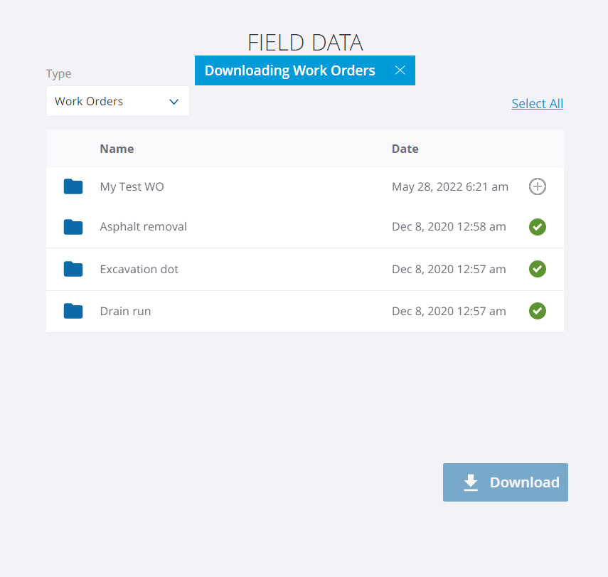

  1. When signed into a WorksManager account and project, select Devices in the left pane.
  2. Select a field data collector device with work orders in the left pane.
  3. In the right pane, next to Field Data, click View. You will see the work orders present in that device
  4. Click the + icon next to any work order that you need and click Download
  5. A status bar at the top of the screen will show Downloading Work Orders until the download is complete (this may take a minute or two).
Unzip/extract the downloaded folder in Windows Explorer, and double click the work order folder in order to see the work order contents

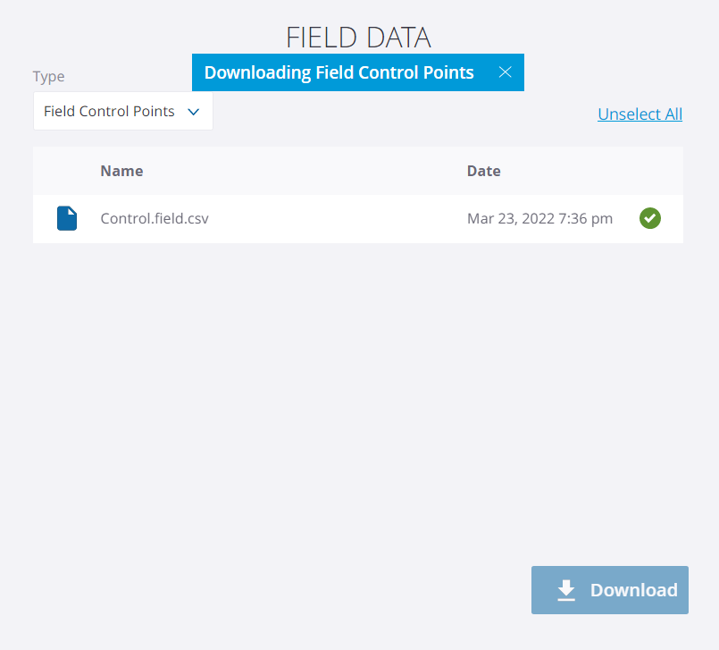

Field Control Points
You can view and download the field control points from any data collector device
  • Navigate to Project Devices -> Select any data collector device
  • Click 'Field Data' - View from info. panel (field data page opens up)
  • Select 'Field Control Points' from the drop down -> view, and download

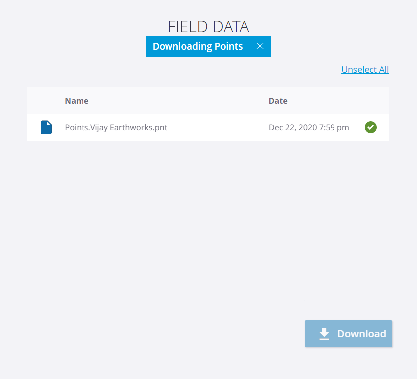

Recorded points (for Machine Control devices)
You can view and download the recorded points from any machine control device
  • Navigate to Project Devices -> Select any machine
  • View, and download recorded points
