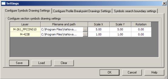

Under settings you will find three panes. Configure Symbols Drawing Setting will show the layers in the drawing where the function finds Landscape symbols. You can then connect symbols to those layers.

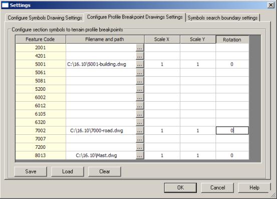

Under Configure Breakpoint Drawings Settings, you get a list of all feature codes. This feature code is read from the cross-sections. You can then decide what symbols to connect to a feature code. If no symbol is connected to the feature code, only the text will be written in the drawing. If a symbol is defined, both symbol and text will be drawn.

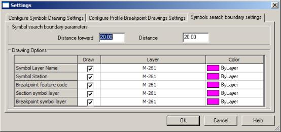

Under the folder Symbols search boundary settings you can define what object to search for in the cross section as well as what distance to use as a boundary.

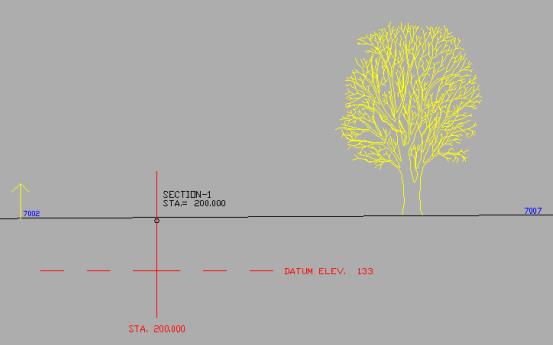

Distance forward and distance are parameters that control how far the function shall search for Landscape symbols for each cross-section. The example below shows a cross-section with both landscape symbols and feature codes with text and symbols:
