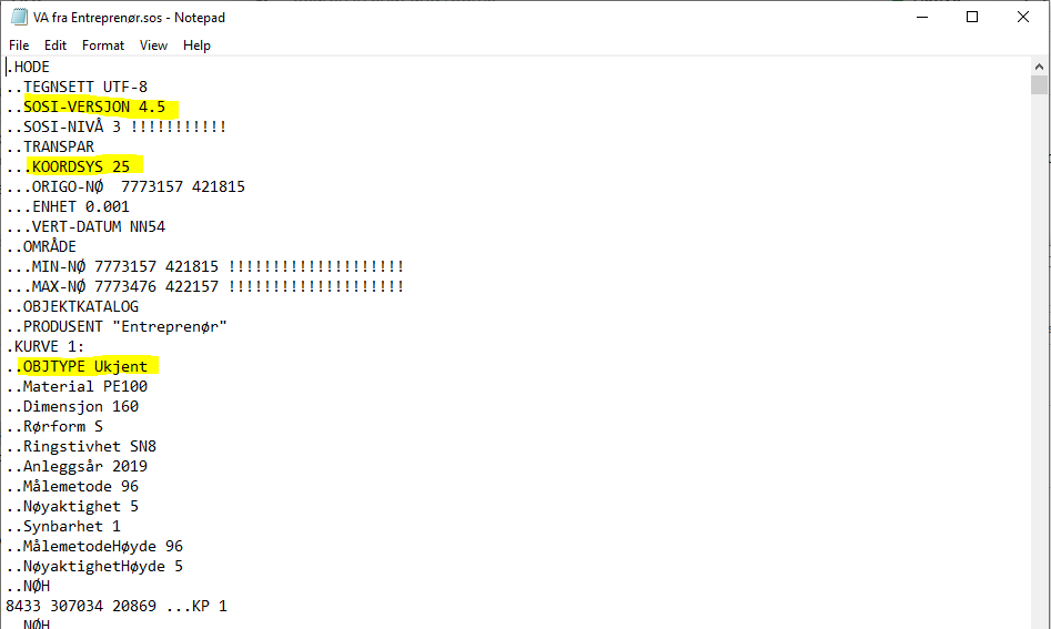

Step 1. Open the SOSI file with notepad (or similar software). Here you want to check what kind of SOSI file you have. and what information is provided.
Check for SOSI version, coordinate system, units, and object types. In this example, you notice that Object type are defined as "ukjent"(unknown). The standard conversion rule is not able to know what an unknown object is. So in this case the produced of this SOSI file should define it. for example Object type: "Waterpipe".

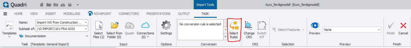

Step 2.
Create an import task, choose your SOSI file and select a conversion rule.
(Quadri will read the information in the SOSI file and help you automatically transform it to the correct coordinate system if needed)
It is the Conversion rule that allows you to transform the information in the SOSI file to objects in Quadri.

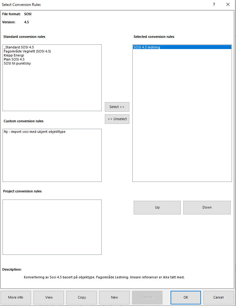

Quadri will read the SOSI file and help you select a conversion rule for that specific SOSI version. in this example version 4.5
Press select conversion rules, and you will notice you can see conversion rules especially made for version 4.5

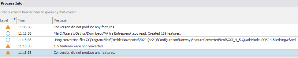

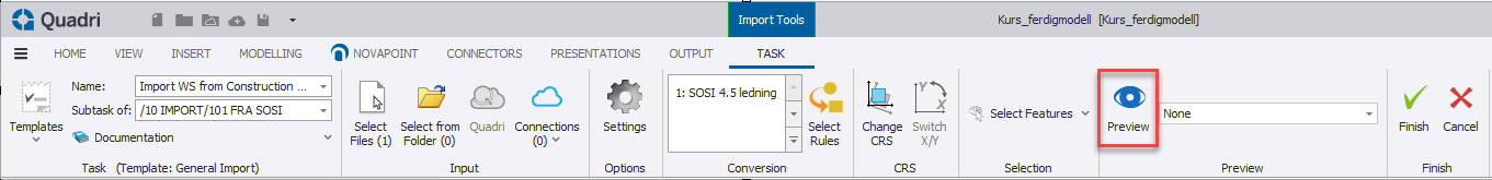

Always press Preview in order to see if your object has been imported or not. in this case, no objects are imported.
and the process window indicates that

In this case, no objects are created as we can see in the SOSI file that all objects types are defined as "unknown"
look at these 2 examples from the file:
This object type is most likely a waterpipe, but since the creator of the SOSI file has marked it as unknown the conversion rule is not able to know and therefore not importing it.
This object could be a sewer pipe, but again we don't know for sure

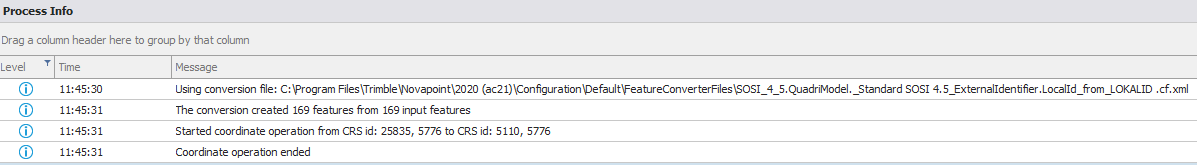

Now I could successfully import the file. This is the preview window after importing the new edited SOSI file:

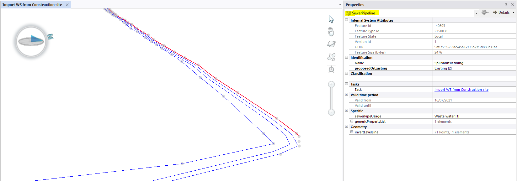

this is the result in Quadri:
