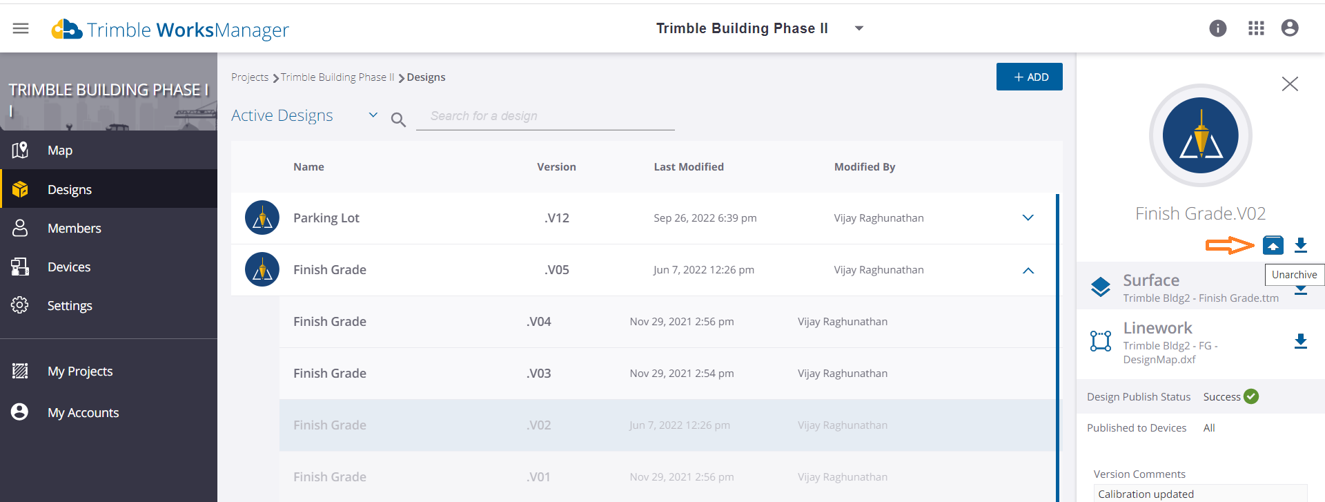

1. Archive design/ design version - this removes data from every device assigned to that specific design
archive design

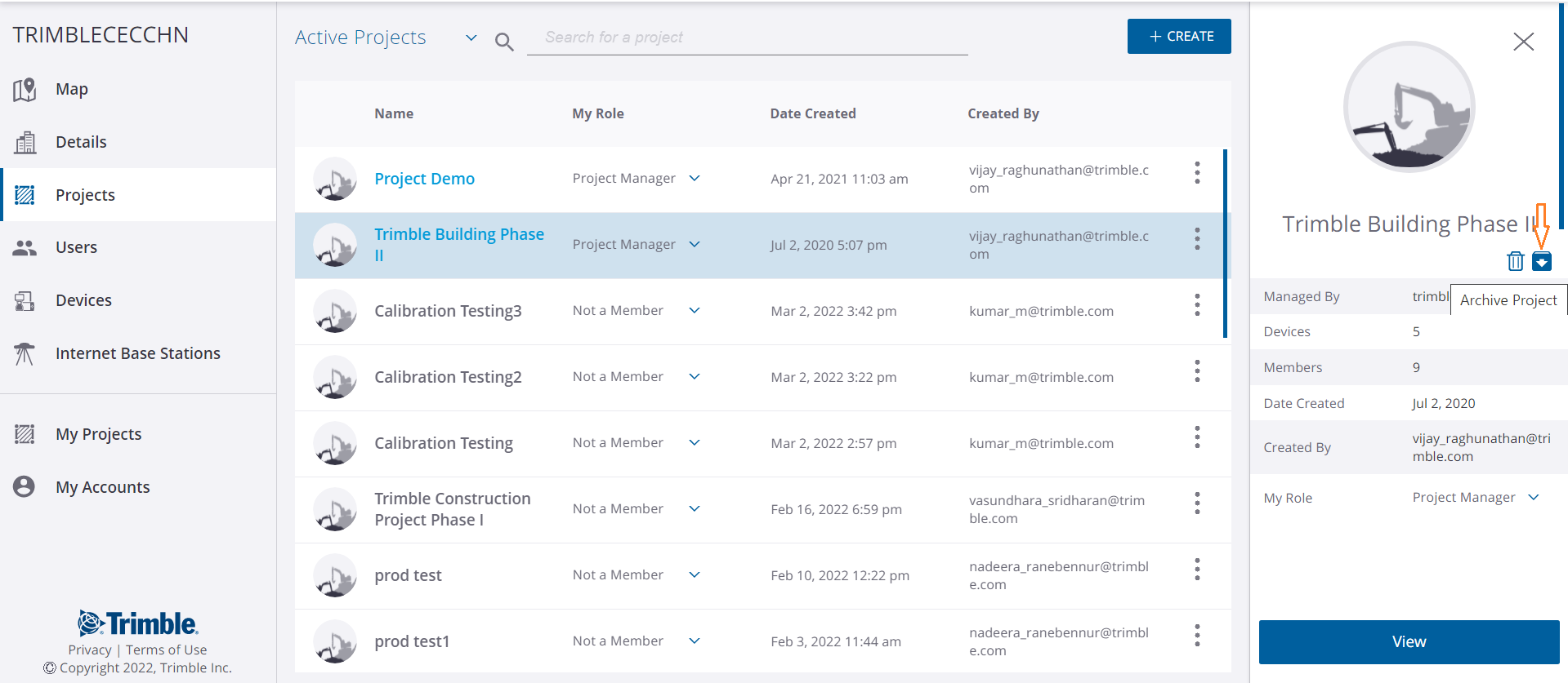

2. Archive project - this removes the entire project data (office, field) from every single device in the project
archive project

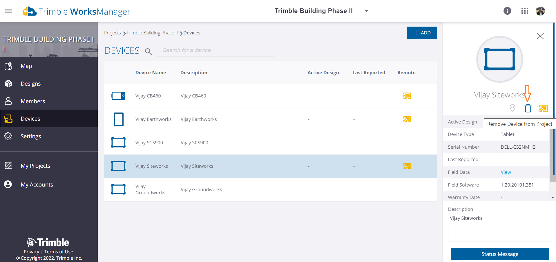

3. Remove device from project - this removes the entire project data (office/ field) from that particular device
remove device from project

1. Unarchive design version from Active Designs list - Select any active design on the list and click on 'View archived versions' option on the left panel to view the archived versions.
Select any archived design version in the list and click 'Unarchive' on the left panel to unarchive the design.
2. Unarchive design / design version from Archived Designs list - Switch to 'Archived Designs' view and select any archived design / design version on the list. Click 'Unarchive' on the left panel to unarchive the design.
3. Unarchive project - Switch to 'Archived Projects' view in the Projects page and select any archived project on the list. Click 'Unarchive Project' on the left panel to unarchive the project.
