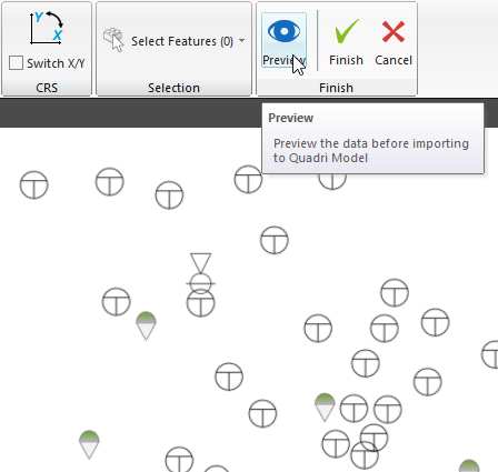

  9. The data is now processed - it will take some time… After the import process is finished it is possible to preview the result: (See more about Visualization rules)
  10. Complete the import by pressing [Finish] in the import tool.
