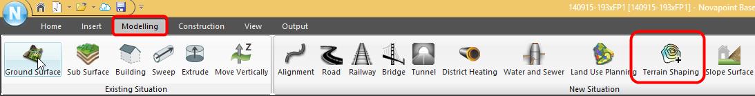

Find it here:
MOUS_ICO Modelling >Terrain shaping

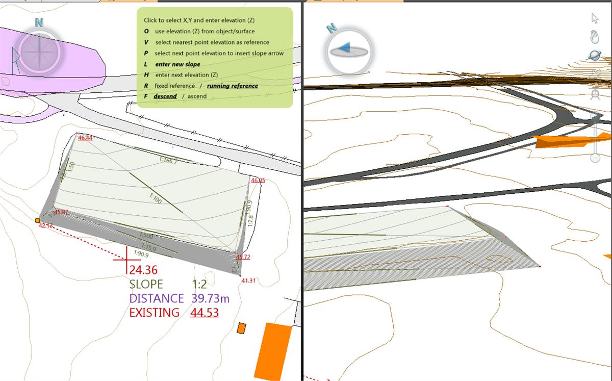

To begin designing the terrain you must have a plan window open.
Tip: Create a separate plan window where you do not have many surfaces so you easily can see the terrain. By having a 3D window open in addition, you will be able to see the terrain in 3D when you are creating the terrain.
Methodology:
  1. Set the first point either by specifying x, y position in the plan window and entering the height, or be in x, y position in plan and press O to use existing calculated height.
  2. Widgets changes according to where you are in the process. You continue to insert new elevetion heights and use various short commands to set guidelines for elevation heights.
These are the different commands you can use:
O: use height(Z) from Object/ surface (the height from input is used)
V: select nearest point elevation as Reference (by holding the mouse near a point it will snap to that elevation point)
P: Select next point elevation to insert slope arrow ( insert a New slope arrrow from an elevation point by holding Your mouse close to the elevation point you want to put a new slope arrow towards)
L: enter new slope (gives the possibility to change the slope value)
H: enter a height
R: fixed reference / running reference (calculates elevation points from one point/ calculates elevation points consecutively)
F: descend / ascend ( the next point will be below the last point/ next point will be abow the last point)
When you press enter you quit create - mode, and you come to a pause mode in which you can click on another location to add a new elevation point, or use V to select one reference point or O to an existing height. You can also click on point or slope to edit this.
