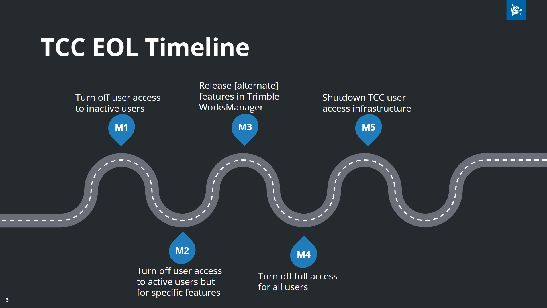

TCC EOL Journey & Key Milestones
Milestone 1 (M1) & Milestone 2 (M2): Setting the Stage
Our decommissioning plan has been executed in phases.
  • Milestone 1 (Q3 ‘25): In this phase, we securely revoked access for all inactive TCC users who had not logged into the system since January 2024, significantly reducing our vulnerability footprint.
  • Milestone 2 (Q4 ‘25): We then disabled specific non-core features (like Contacts) and features with WorksManager equivalents (like Remote Access) for active users. During this phase, we also successfully migrated approximately 90% of our non-sharing Internet Base Station Service (IBSS) customers to a newer, more stable technology stack.
Milestone 3 (M3): New Transitional Features - May 22nd, 2026
Milestone 3 focuses on releasing alternative features within Trimble WorksManager to bridge the gap as TCC goes EoL.
What Is Becoming Available? (May 22nd)

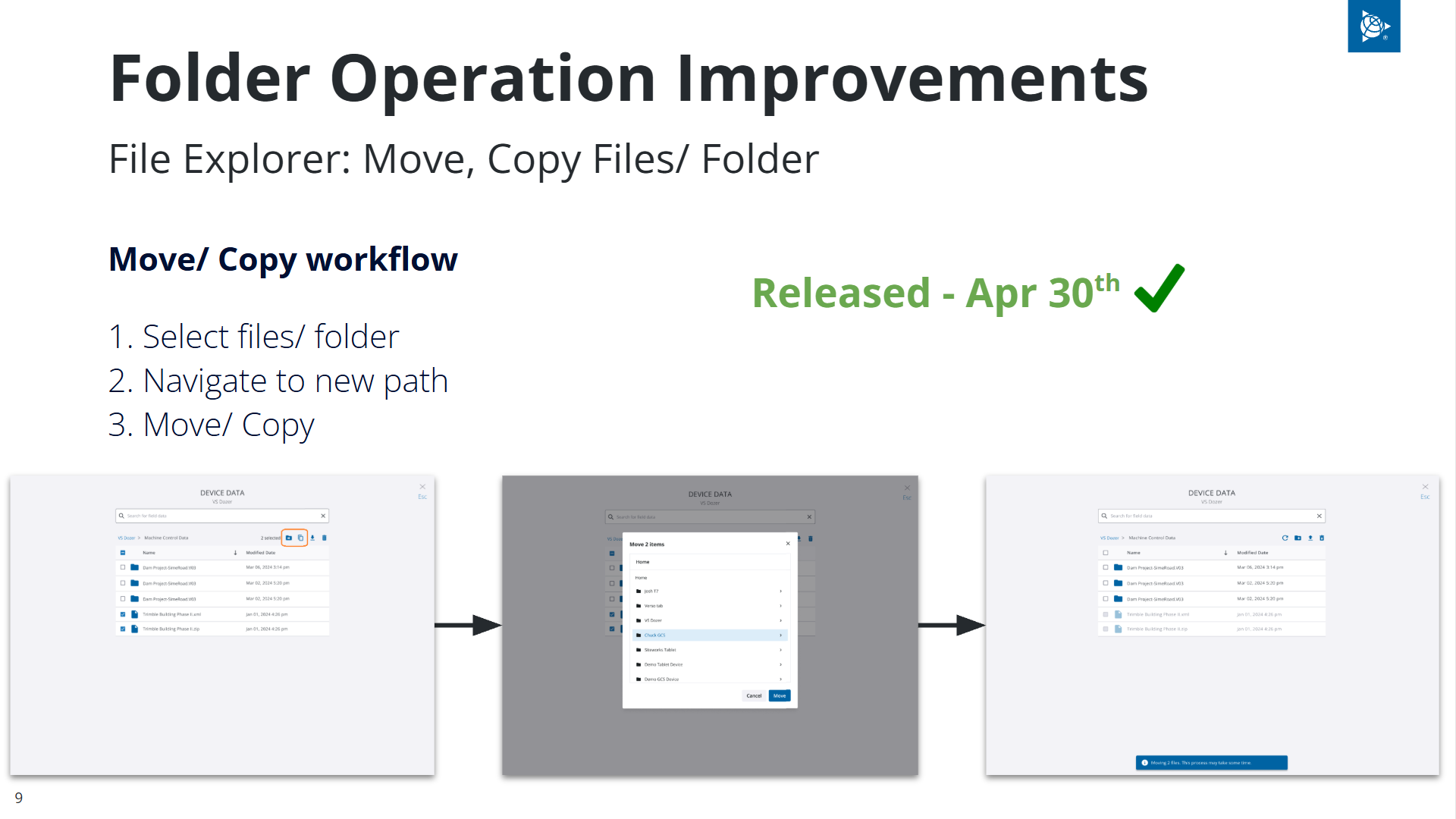

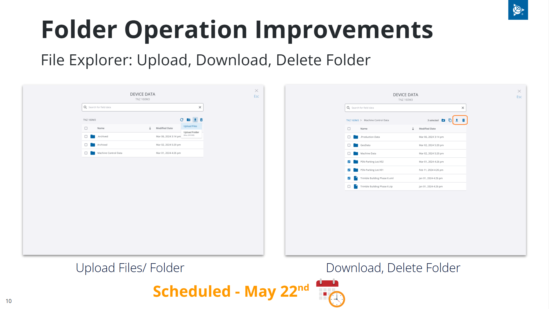

  • Enhanced File Explorer (Folder Operations): While basic file operations have existed in WorksManager, we are introducing folder-level operations. Users can now move, copy, and delete entire folders directly within the web interface. This acts as a direct wrapper around TCC, meaning any data stored in TCC is visible and manageable here. This is highly useful for use cases like moving work orders from one surveyor's data collector to another. The ability to upload, download folders is scheduled for release on May 22nd

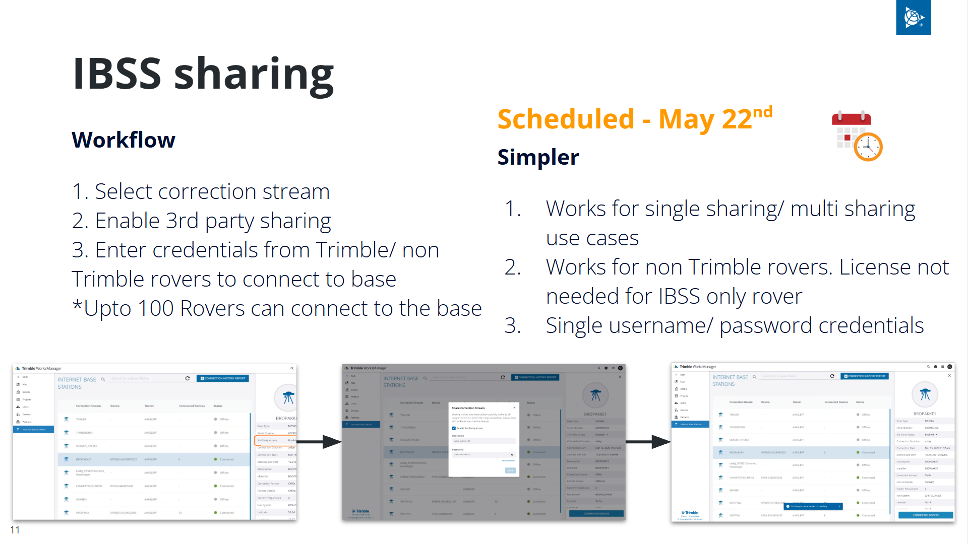

  • IBSS 3rd Party Sharing (May 22nd): For customers who share rovers/ bases across one or more accounts or use non-Trimble rovers, we are introducing a "3rd Party Sharing" feature. You simply enable this on your correction stream to generate a single username and password. This credential can then connect up to 100 rovers (either shared Trimble rovers or non Trimble rovers)
What Is NOT Directly Available:
  • No Automatic Synchronization: Unlike the Office Synchronizer, WorksManager File Explorer does not feature automatic background syncing between local folders and the cloud. Users must manually manage their uploads and downloads via the web interface.
  • No Offline Desktop App: There is no offline desktop equivalent to TCC Explorer being released; all file management must happen through the WorksManager web portal.

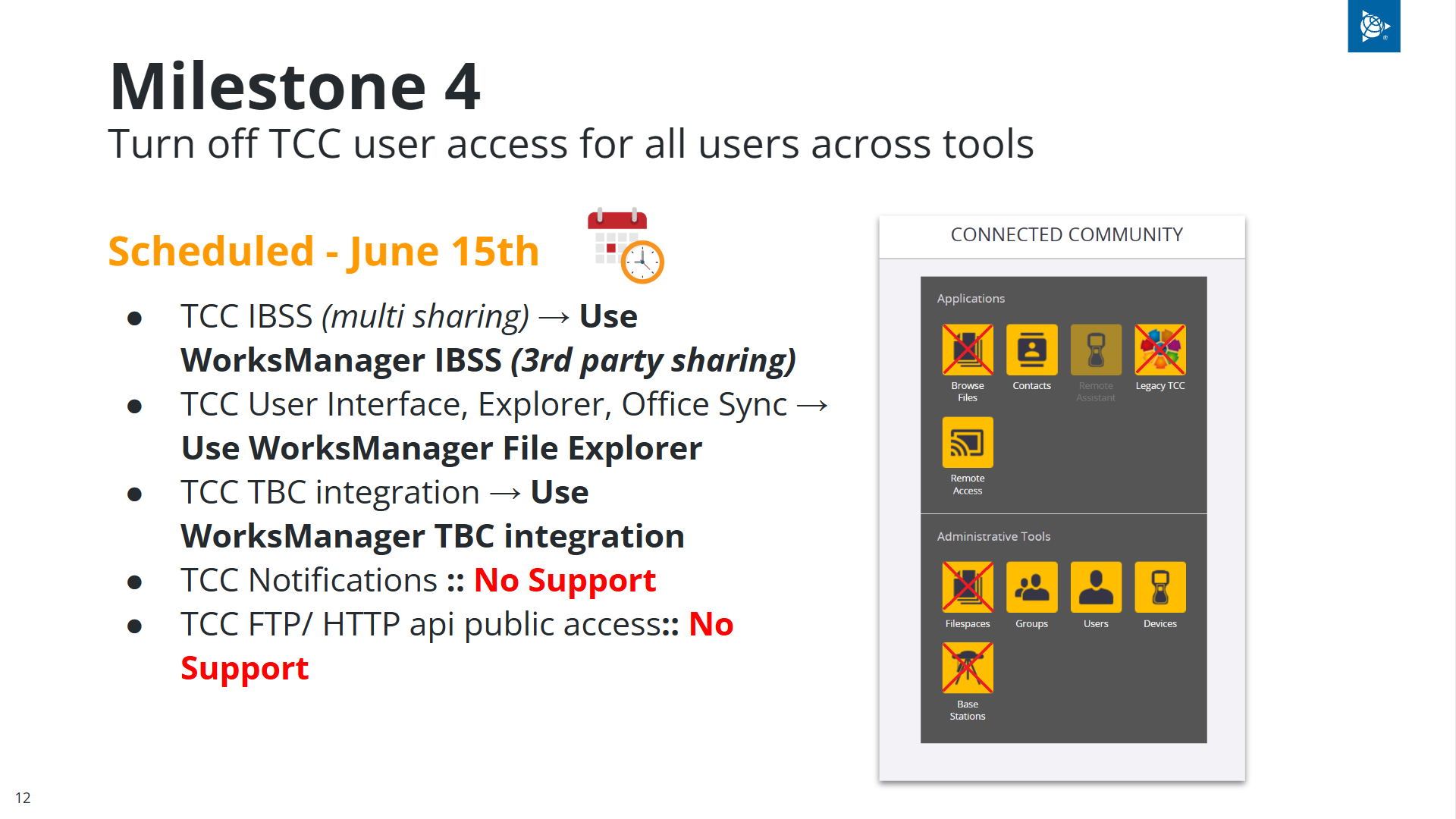

Milestone 4 (M4): Total Revocation of Access - June 15th
Milestone 4 will trigger the complete revoking of TCC user access across all platforms.
What Is Going Away:
  • TCC Desktop Tools: TCC Explorer and Office Synchronizer will completely stop functioning.
  • Web and API Access: The TCC User Interface, FTP access/ HTTP API access, and user notifications will be permanently deactivated.
  • TBC-to-TCC Links: Direct publishing to TCC from TBC will be removed entirely in TBC v2026.10. In older versions, the functionality will not work.
  • Historical Connection History Data: All access to V1 IBSS connection history reports will be gone. If you do not download them before June 15th, they will be gone.
What Will Continue to be Available (Post-June 15th):
  • Legacy Device Support: Older devices like the GCS900 that rely on TCC sync will continue to function without disruption. We have built a proxy layer that intercepts their requests, keeping your hardware operational without relying on the retiring infrastructure.
Milestone 5 (M5): Internal Infrastructure Shutdown
Milestone 5 is a final, strictly internal phase focused on shutting down the entire TCC user access infrastructure. During this phase, all remaining UI access will be revoked for our internal teams. This will be executed shortly after the external-facing shutdown, with the full infrastructure shutdown officially scheduled for June 20th.
Key takeaway: Any/ all forms of user access to TCC will be revoked on Jun 15th. This includes TCC user interface, TCC Legacy interface, TCC Explorer, TBC Office Synchronizer, and TCC FTP/ HTTP api access.  Alternate features including File Explorer - Folder Operations, and IBSS 3rd party sharing are scheduled for release in Trimble WorksManager on May 22nd.

Q: What happens to customers on old IBSS v1? Customers using shared rovers on v1 must use the new third-party sharing feature to create credentials and configure their rovers. Once confirmed, they will be migrated to v2.
Q: Is IBSS partnering cancelled? Legacy TCC IBSS sharing is indeed revoked. You must now use the new WorksManager "3rd party sharing" feature to achieve this workflow.

  1. Configure IBSS 3rd Party Sharing: For any shared base/ rovers or non-Trimble rovers, enable the new "3rd Party Sharing" in WorksManager for the base correction stream and input the generated credentials into your rovers by Jun 15th. We will share step by step instructions as we release the 3rd party sharing capability on May 22nd.

Question: Can I delete a folder with contents? I use this when a site gets uploaded to the wrong data collector unit by accident, or if someone creates an unnecessary site on their data collector, or if I upload something just to test a current or new feature
Answer: Yes, the enhancement to delete a folder with its contents is now available in WorksManager
06-04-2026 00:37
Question: 'Can I rename a folder? I do this when transferring work orders because it is common to have work orders with the same name on different units'
Answer: ​This feature is not readily available. However, as a workaround, you can download the work order from data collector unit 1, rename the folder locally, and upload it to unit 2. Though not ideal, this should help proceed.
05-31-2026 20:31
Question: 'I am not able to select multiple folders to upload at the same time. Is there a limitation?'
Answer
Yes, this is a limitation now, you cannot select multiple folders. However as a workaround, you can achieve the same result by doing this.
Step 1: Wrap the multiple folders into a single temporary folder
Step 2: Upload the single folder to WorksManager via the File Explorer
Step 3: Use 'Move' feature to unpack the contents, and then delete the temp folder
