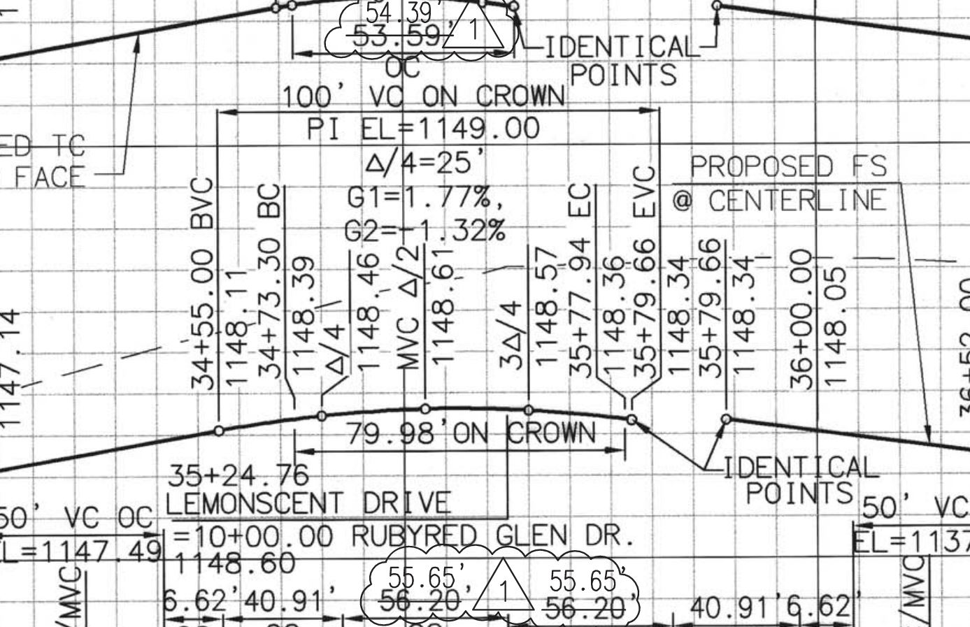

Snip of the CL profile info with VC/crown info.

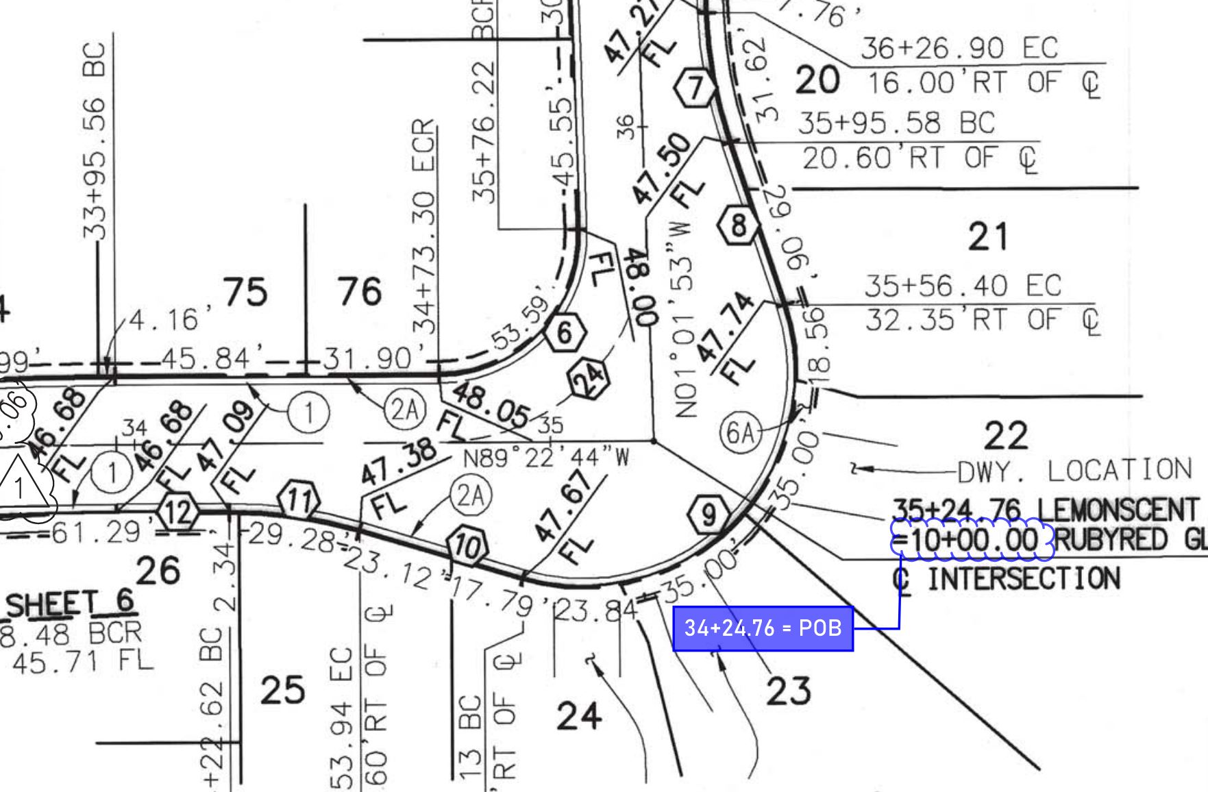

Plan view of AOI.

You could create a linestring.  Open the property and for the name add a underscore and if you want add a name after it. Example” _crown”   Can’t remember at the moment if it is two or one underscore.  With the a new property setting will appear giving you a chance to add a begin station.  This may help with the stationing to get the right VPI station.
