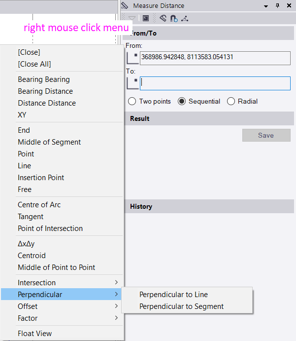

posted 02-12-2022 18:51
The explore object is one good way, but you can use the "Measure Distance" as well. In all coordinate pick fields you can find various options in the right mouse click menu.
