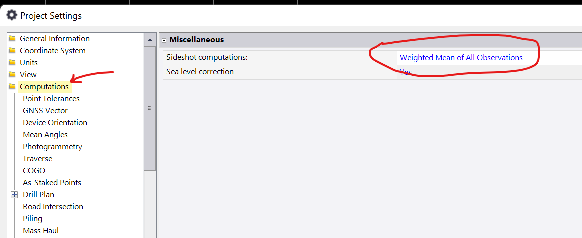

I have 2 additional considerations:
  1. If you go to Project Settings > Computations, what is your current setting for "Sideshot computations"?
  2. Have you considered running a Network Adjustment?
Dustin Sunderman's profile image
Dustin Sunderman
Hey Scott,
That bit of information helped a lot. TBC must have reset a default in there to single observation, and that is what was flagging up all my points. Ultimately, this is going to get adjusted out but I need to understand what my problem was. Now I can get into the other issues.
Thank you for the help!
