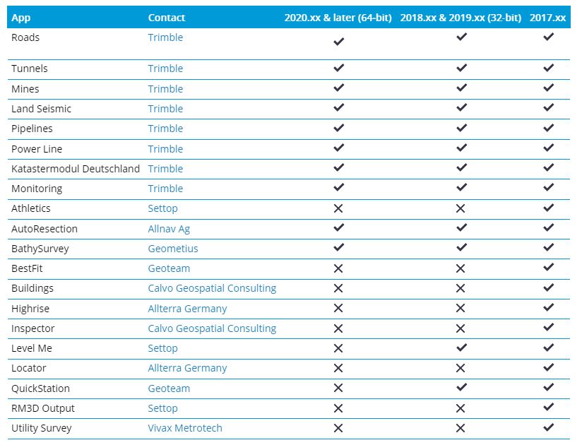

Good to hear that I'm not the only one who can see the benefits of
'differential trig levelling'!
The only reason I was asking about a workflow in Trimble Access is that it looks like Level me is not supported past 2019.xx.
