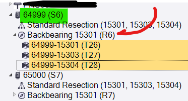

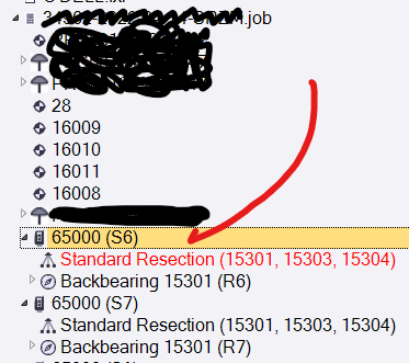

Locate & select the offending Station Setup entry(ies):

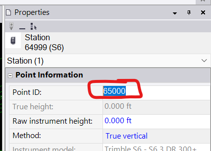

Change the "Point ID" field in Properties to something unique:

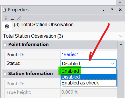

Then select the sideshots under the subordinate "Backbearing" entry(ies):
...and make sure they're "Enabled":
...and then recompute.

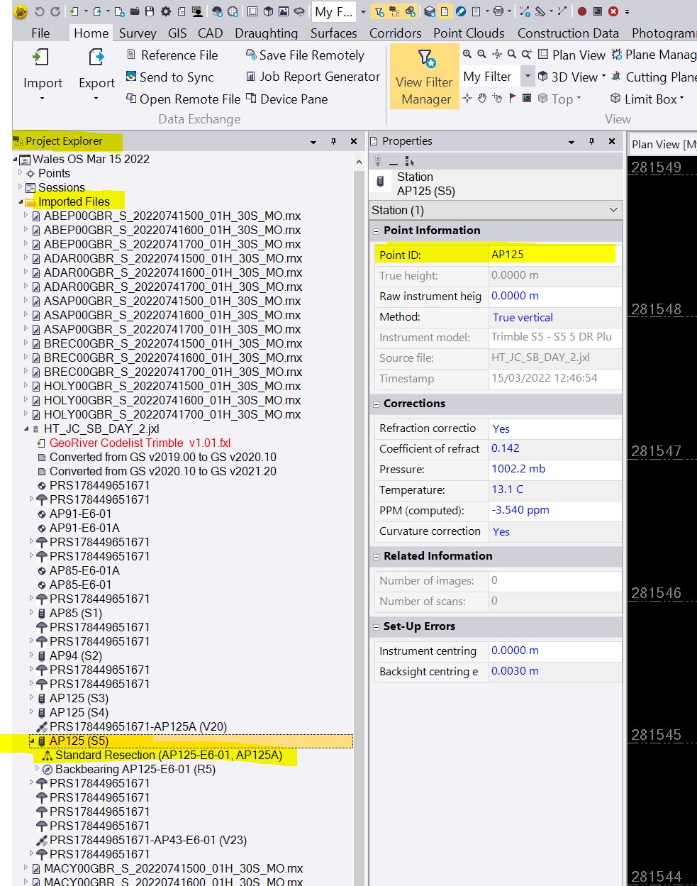

Have the previous setups definitely been deleted? In TBC, use the Project Explorer to browse into the imported job/jxl file and you will see all the stored setups listed. If you examine the properties for each setup you can provide each one with a unique name and then recompute the project. See attached example image.
Regards, Richard.
Project Explorer and Properties to rename the point given for a resection setup.
