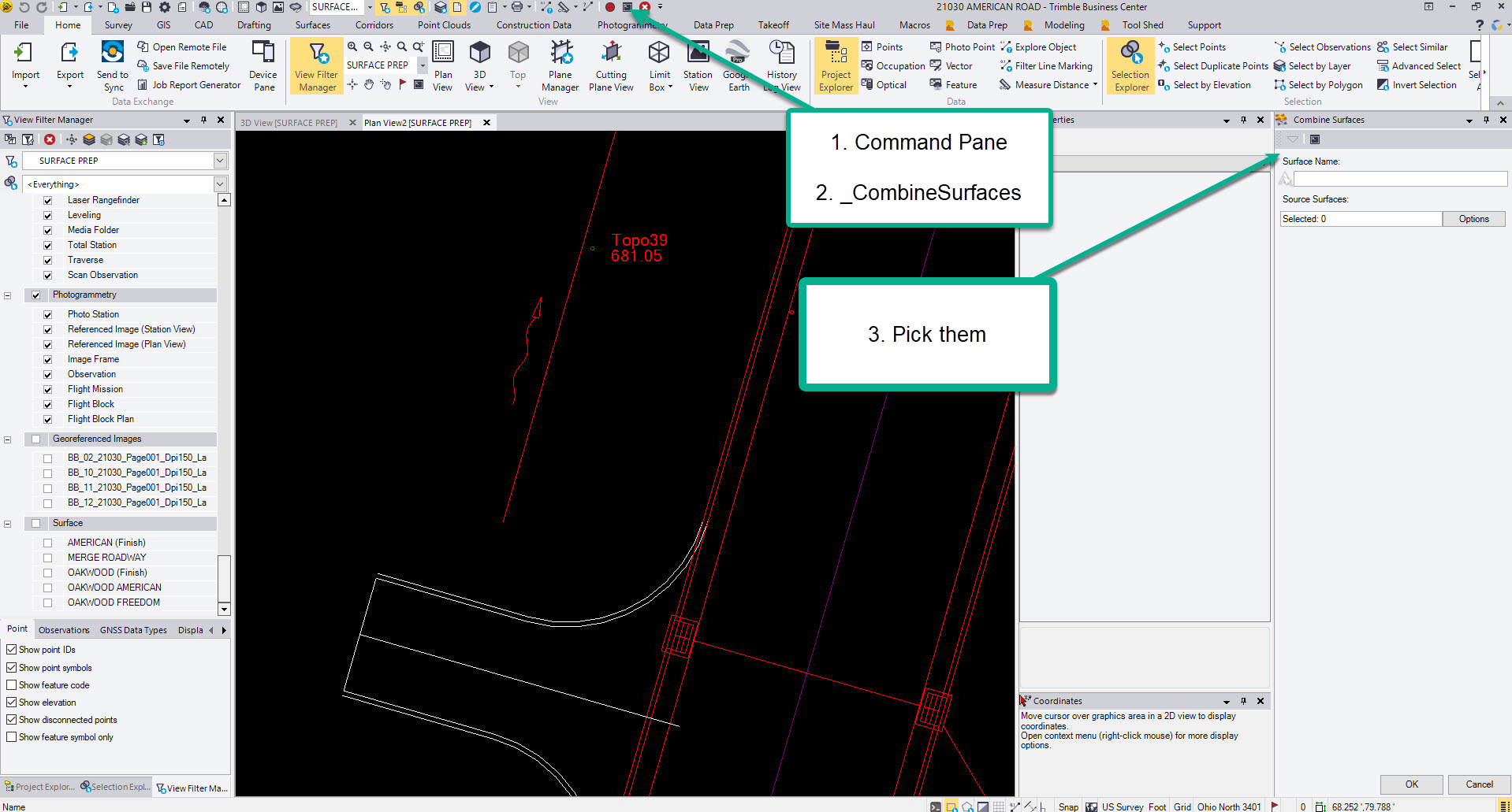

You want the macro '_CombineSurfaces' (I think it's a macro, anyways).
See image.

You can just create a new surface and select the imported surfaces as the surface members. When a surface is added to another surface, it's data is added as points and breaklines.
