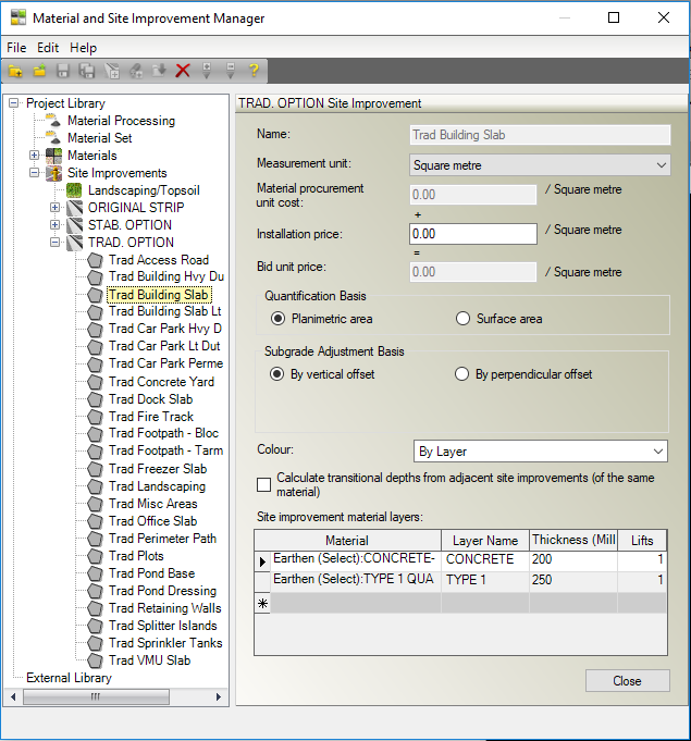

Is there a SMART TEXT code for just the Material Layer for layer within the MSI manager. There is a command for Material Layer Thickness (MT) for the overall thickness but not individual layers.

    Hi Alan,
    Thank you for responding. What i'm trying to achieve is design a smart text that will allow that will display the individual site improvement material layers in order to create a CDP (Construction Design Plan) drawing.
    Also is it possible to achieve this in Plan Sets and not it Plan View.
    Kind regards,
    Bruce
    Material and Site Improvement Manger_Screen Shot

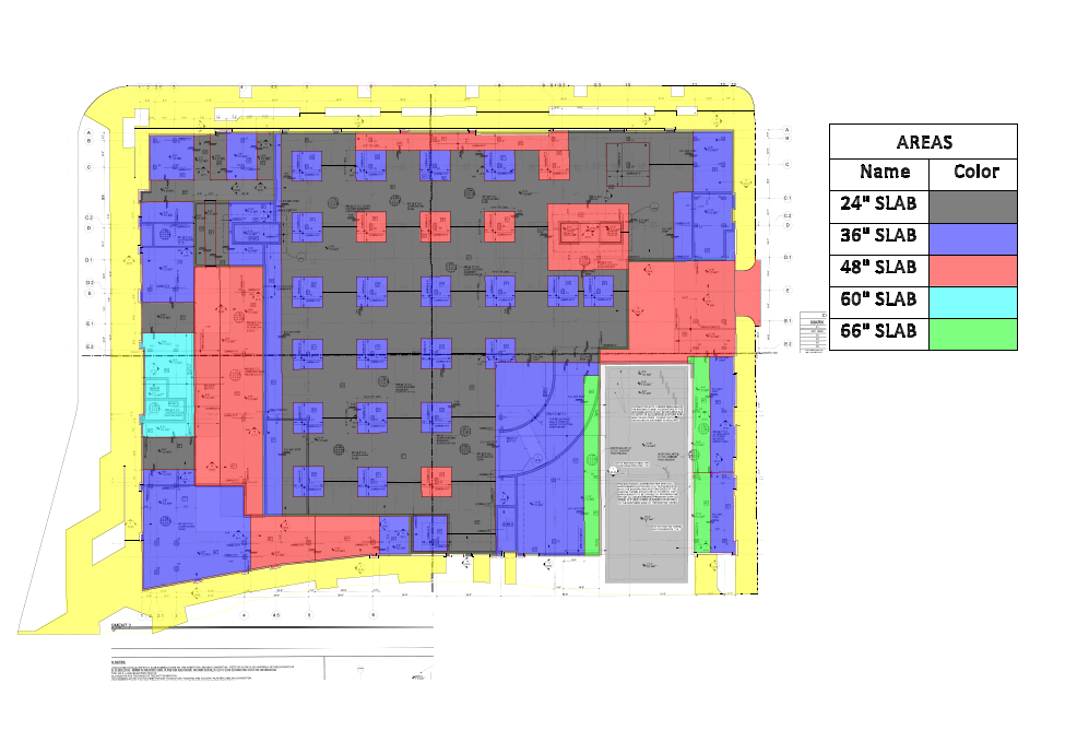

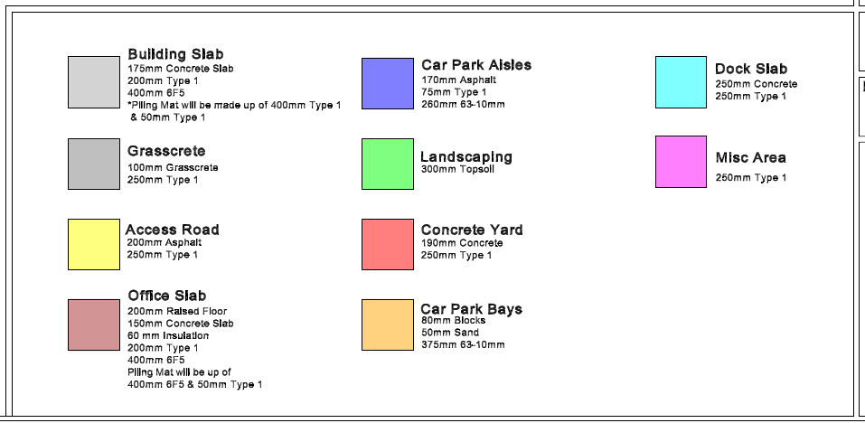

    Thanks for your time on the phone today - awesome to meet you and get this discussion underway. For anyone else watching this thread I have a question.
    What Bruce is asking for is the ability to create a Site Improvement Legend on a Drawing Submittal (a bit like the Cut Fill Map Legend but different) that captures all of the Site Improvements applied in a Takeoff  / Site Model and creates a Legend Block that can be placed directly on a Drawing Sheet or Dynaviewed to a drawing sheet that shows something like this for each Site Improvement used. He wants that to be Dynamically updated as Site Improvement Material Layer Thicknesses change or if additional material Layers are added or if new Site Improvement Areas are added after the Site Improvement Legend is created.
    The Squares would be filled with the applied site improvement color (in the Map of the project)
    The Site Improvement Name followed by the Site Improvement Layers and Layer Thicknesses placed automatically using Smart Text that updates or can be refreshed whenever changes have been made.
    Do others out there have the same need - I think it is a great idea / request and would like to gauge the interest from others out there doing similar work.
    Bruce's company does Site Engineering Design for their clients and this is a deliverable, however I could also see this as a Drawing that I would give a Foreman on site to know what was expected in different areas of the job.

    @Alan Sharp yes. This is something I have asked for myself. It is useful for passing on information to someone who is not using CAD; presentations, deliverables, takeoff verification.
    brucewisternoff@hotmail.co.uk">Bruce Wisternoff Thanks for asking this! I would have forgotten until the next time I needed it and been in a bind.
  • 7.  Re: Is there a SMART TEXT code for just the Material Layer for layer within the MSI manager. There is a command for Material Layer Thickness (MT) for the overall thickness but not individual layers.
    Posted 10-18-2018 08:16
    Yes @Alan Sharp! I actually have been having to do this manually. Generating a label table and exporting/importing it then explode it to edit it. It would be awesome to have a color type map reference.

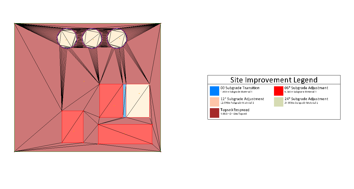

    Bruce
    Christmas may come in January for this one - but I wanted to share a video with you
    I think we are real close to having what you wanted in terms of a Site Improvement Legend
    Let me know what you think
  • 12.  Re: Is there a SMART TEXT code for just the Material Layer for layer within the MSI manager. There is a command for Material Layer Thickness (MT) for the overall thickness but not individual layers.
    Posted 12-01-2018 05:29
    Awesome. The legend looks good and the workflow looks simple. Will the legend also recognize textures?

    You just pick the reference surface i.e. oG or FG and you can create as many Legends as you want (over and above yourself that is)

    Posted 01-18-2019 15:36
    Please check out the TML named SiteImprovementLegend" that was posted today. You should get the 5.0 patch first (which was also posted today)
