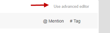

    Posted 10-12-2020 09:53
    Hi Jon, you may switch to the advanced editor mode as below, then you will see an upload option:
