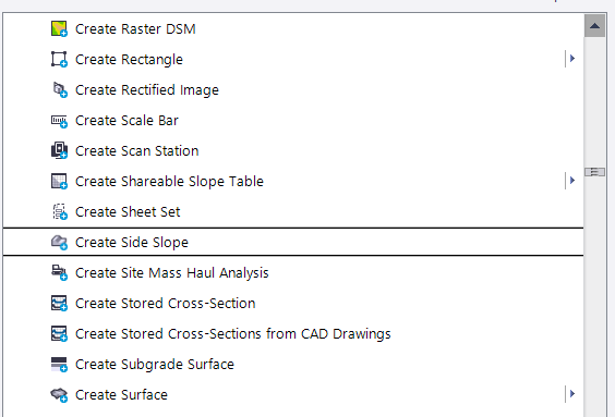

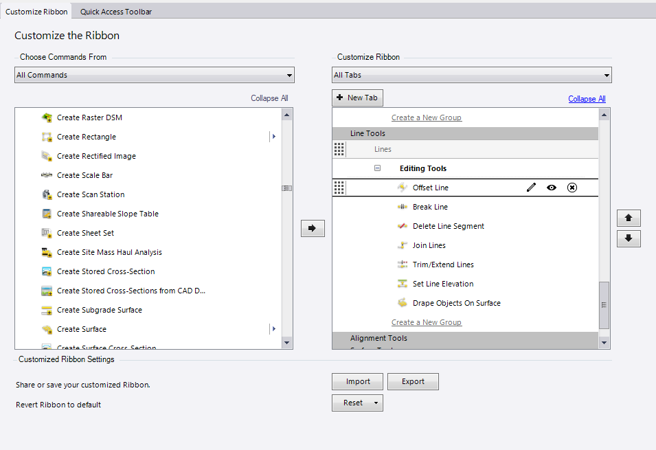

    I'm currently looking for create side slope command in my customize ribbon and I can't seem to find it (Maybe I'm blind). I'm having to open the command pane and run it every time I want to use it. It would be nice if there was a search function on Customize ribbon rather then having to scroll all the way through the list. Its rather long.

    it is "Create Side Slope"
    If it is already in your Custom Ribbon Group or in the Menu ribbon you are changing, then it may not appear in the list as it is already assigned to the Ribbon you are working on.
    Don't disagree that a search would be good here - but my guess is that that request will be relatively low priority because you don't use this function that often and changing it will not lead to big productivity gains like many other requests right now at least

    Posted 08-29-2019 15:57
    Are those saved ribbon settings from an older version of TBC? You won’t find it if so. I remember that happened to me. Save you ribbon, reset the settings, restart TBC and see if you see it then.
    I had a custom ribbon form 4.x and noticed I was missing a bunch of stuff. I think it’s a bug.

    Part of the reason there needs to be a way to export and load just one or select tabs in the custom ribbon settings.
    I believe it wipes out everything when you load a custom ribbon. This is a bigger issue when you load an old version of TBC ribbon settings to a new version of TBC because the commands are masked by just the old command list. So I hypothesis at least.

    It is not a bug unfortunately - an old ribbon compiled in an old version will not show commands that were added in a later version - that is why I have to create an all new Ribbon at each release - takes almost a whole day for me to do that - the ribbon has to be built from the standard one that ships with a version and then you will get the new Icons and New commands to work with.
