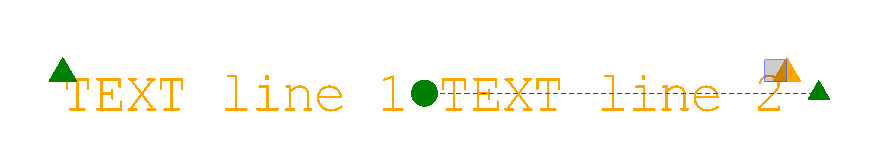

    When you pick a CAD text object, you can use several grips to control it.
    Click-and-drag:
    • the circle at the insertion point to move the text
    • the triangle in the upper left to adjust the height
    • the triangle in the lower right to change the rotation
    • the triangle in the upper right to changes the aspect ratio (the text gets skinny or fat); if you hold the Control key down while you do this, you can narrow the invisible bounding box, causing the text to wrap.
    This is also mentioned in the TBC help topic "Move and Modify CAD Objects Using Grips".
