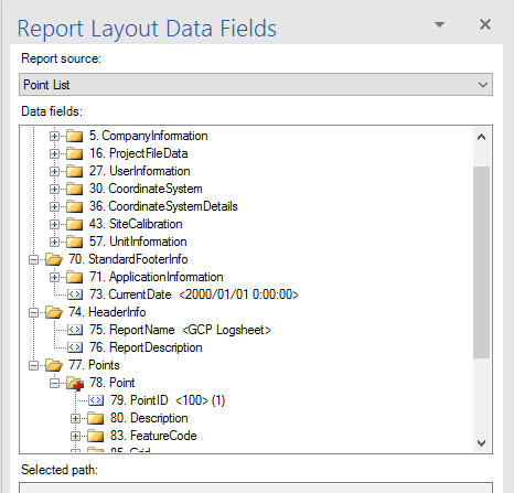

    We have created a custom word doc logsheet export in TBC.  We have included photos etc along with all the many of the values that you can choose in the custom export builder.  What cannot be chosen to be displayed with this export are any values pertaining to the vector used to establish the point. For RTK vector created points would be nice to display for example PDOP, Start Time, Stop time, or any of the statistical values associated with vector used to create the point.  It seems you are now limited to just the Point Information data.

    I have created a custom word doc report.  When I edit the layout in the Report Layout Data Fields you dont have access to any statistical vector data, just point data along with some of the project settings etc etc.

    This sort of RTK data isn't available to add to custom reporting. A big issue with this is there is not 1:1 relationship between a point and an observation. A point can be derived from multiple observations. For example there may be an average of multiple RTK vectors to create a Northing and Easting position and an elevation derived from a level observation. This is something we can look at improving but it will be limited by this behavior.
