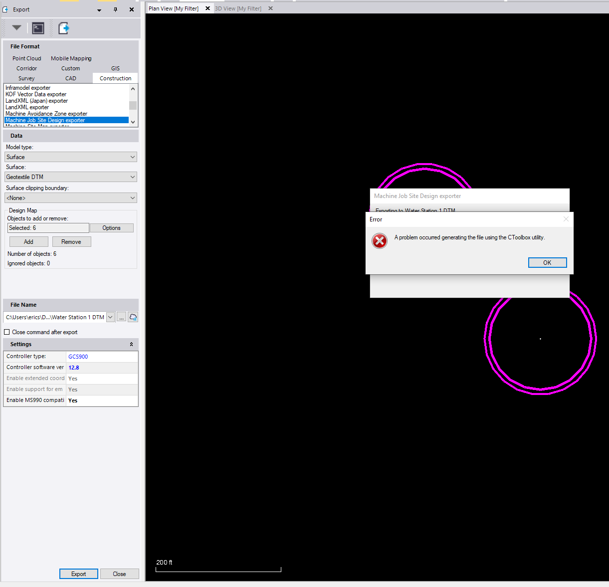

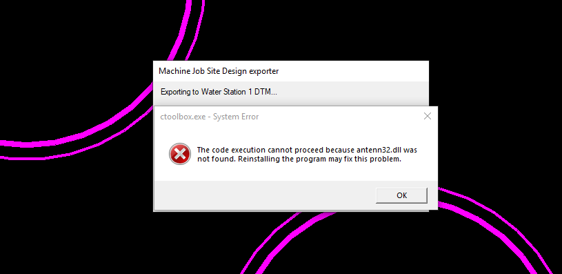

    When trying to export a project, see the attached error I receive. I tried reinstalling Business Center and used the Cleanup Utility. I tried exporting and importing my surface and linework into a new file to see if that made a difference and it didn't. Any ideas?

    I was able to copy the antenn32.dll from the C:\Program Files (x86)\Trimble\convertToRINEX\ folder and paste it into the C:\Program Files\Trimble\Trimble Business Center\ folder and it fixed the issue for me.  The problem started when I updated to 5.10.

    I was able to search for this file in my program files and found it in the Convert to RINEX program, copied it from there into the Trimble Business Center program files, then the export worked normally.

    I got the same error message when creating machine designs "Machine Job Site Design Exporter" along with another one "A problem occurred generating the file using the CToolbox utility". I tried multiple versions with different linework and surfaces selected but could not export from desktop. When I opened the same project from my laptop, I was able to export them from it. I exported designs the same way prior to yesterday and it has worked fine. I un-installed, ran cleanup (found on forum from Alan) & re-installed with same issue but after 4 times with that process it worked and I'm now able to export machine designs again from my desktop.

    I had the same issue in 5.30.  Copying antenn32.dll from C:\Program Files (x86)\Trimble\Shared TO the folder: C:\Program Files\Trimble\Trimble Business Center

    Same as everyone above (TBC 5.30).  Exported fine to GCS900 version 12.81 & 13.0 (provides a .cal file) but needed the cfg file for an older machine so obviously this antenn32.dll file is required for 12.4 and older exports to get that cfg
