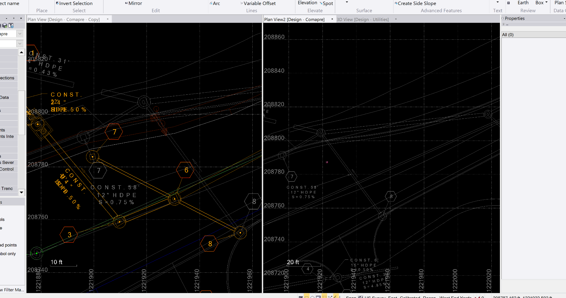

    I'd like the Plan View to be centred on the same point in both views, if I choose to Pan or Zoom in one tab, the same operation would be performed in the other tab.
    Is it possible, while working with two Plan View tabs, to lock view operations so they would be performed on both tabs simultaneously?

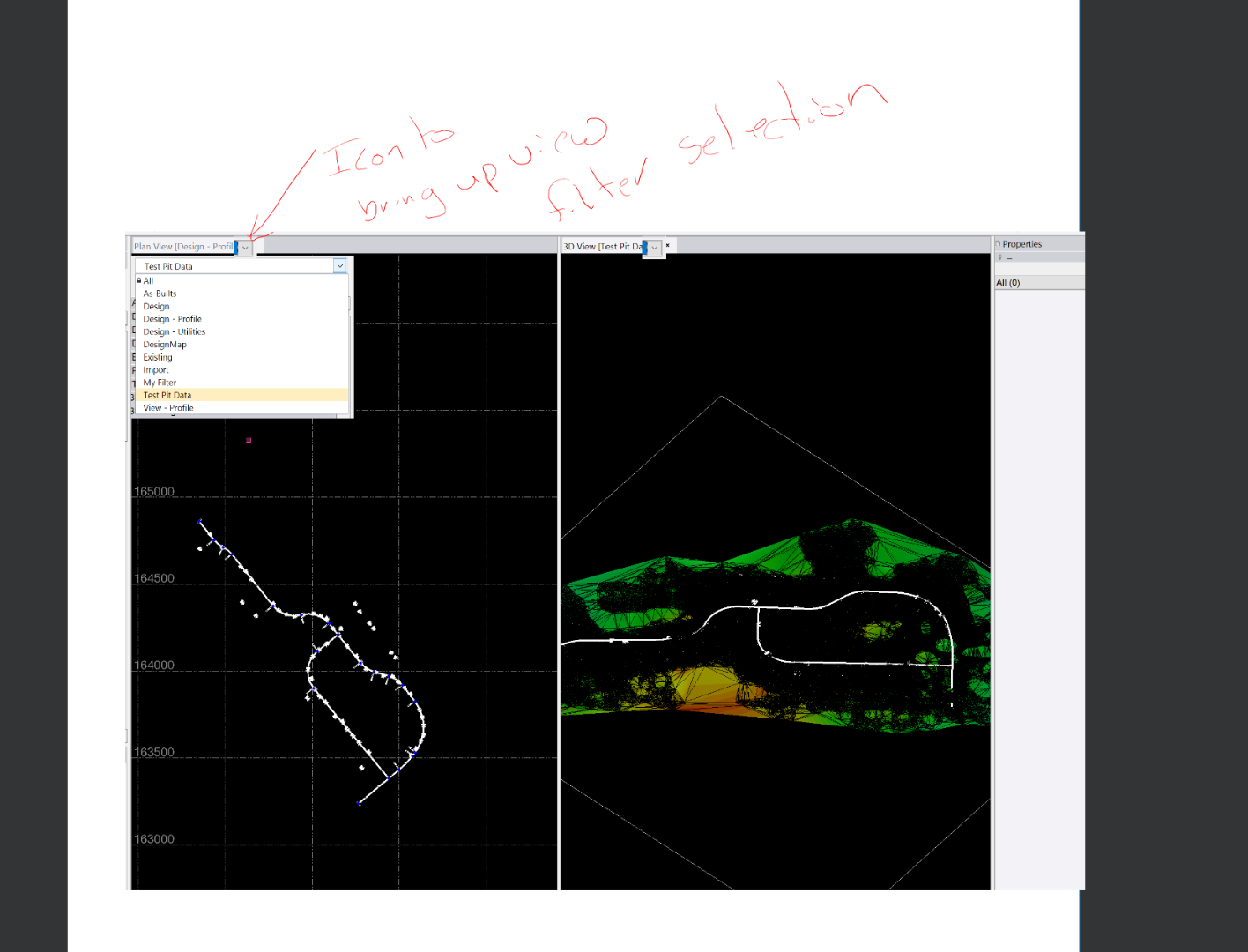

    Being able to click on the tab and pick the view filter would be awesome. Especially when working with multiple windows and multiple screens.
    Something like this:
