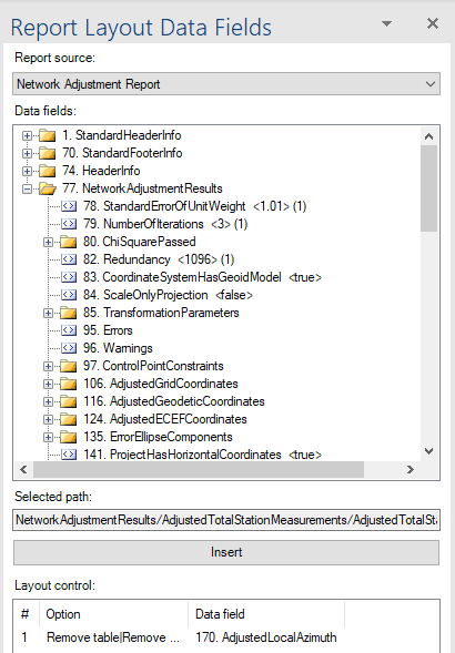

    Having looked further into custom reports, it appears that data field are restricted depending on which report is used as the "source". Is there a way to enable these data fields and make them all accessible?
    Report Layout Data Fields
    Ideally when customising this network adjustment report I'd like to show the observed azimuth, adjusted azimuth and residual within the same row.

    Hi Paul,
    The current NA report template already includes adjusted azimuth and residual for each observation, do you want to add the pre-adjustment azimuth to the report as well? Are there anything else you'd like to add to the report?
