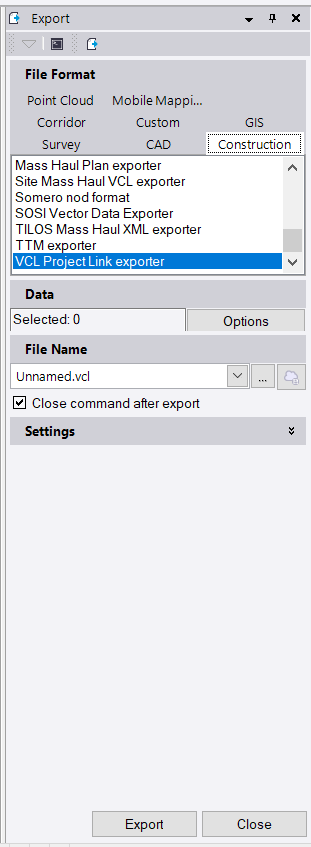

    Matthew,
    Have you tried exporting data using VCL Project Link exporter?
    Go to export, click on the Construction tab, scroll all the way down and choose VCL Project Link exporter. This is the easiest way I transfer data from one TBC file to another TBC file.

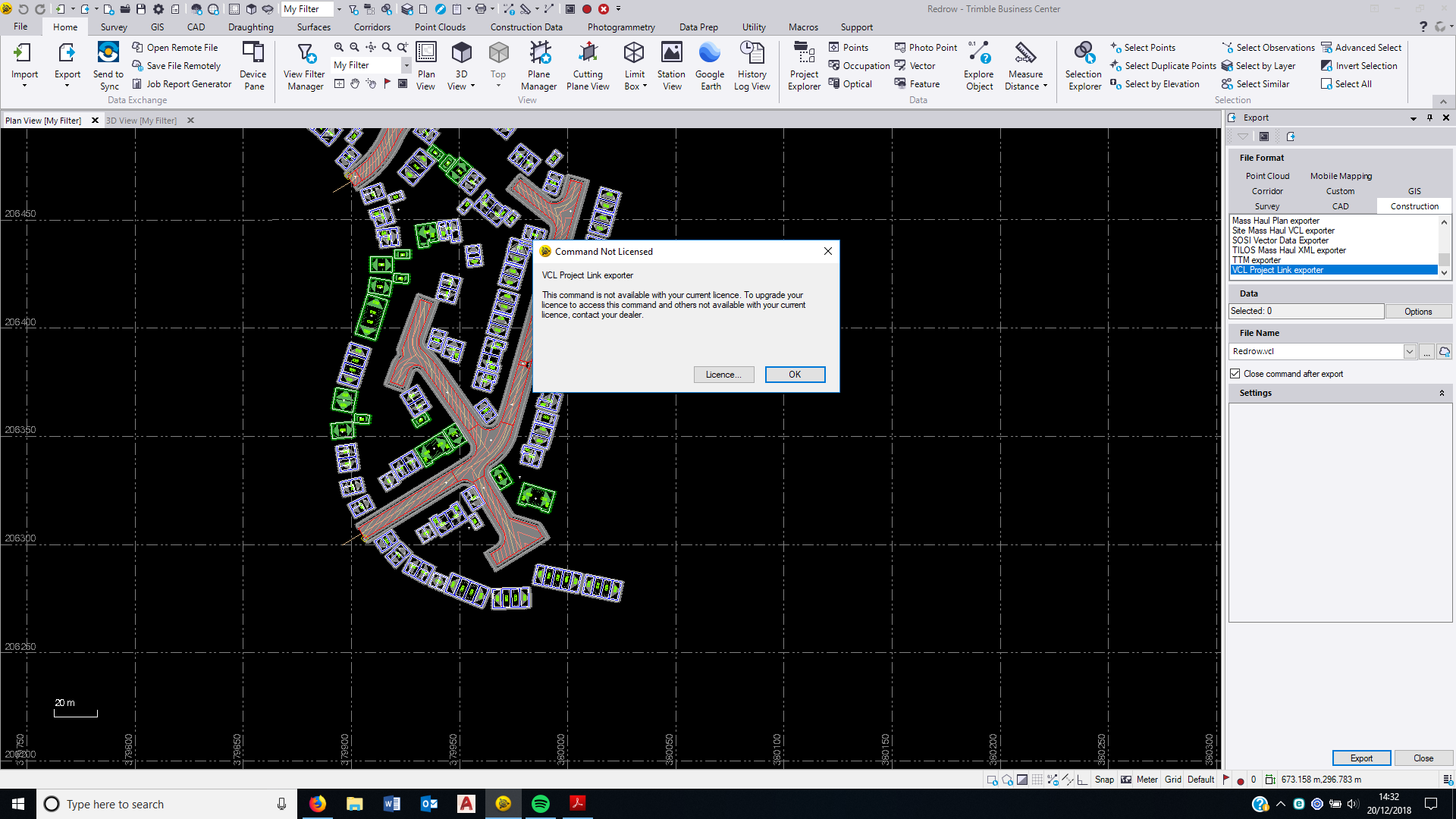

  • 4.  Re: Parallel Working on a single project
    Posted 12-19-2018 09:29
    Looks like it's not included in the Site Modelling Edition
  • 5.  Re: Parallel Working on a single project
    Posted 12-19-2018 19:27
    VCL is in the Site Modeling edition for sure - it is at the base of the list and is called VCL Project Link Exporter
    The VCL file is a native TBC file with things like Raw Survey data suppressed. It is the richest data exchange and carries all types of data natively as TBC Objects - for doing what you are doing it is the only way to go.
  • 6.  Re: Parallel Working on a single project
    Posted 12-20-2018 07:37
  • 7.  Re: Parallel Working on a single project
    Posted 12-20-2018 15:18
    I have asked product management to look into this - it should be included in like the Field Data Edition - I am surprised but it could have slipped through the net in the TBC 5

  • 8.  Re: Parallel Working on a single project
    Posted 12-20-2018 12:43
    Matt;
    I've found the same problem with the VCL export.
    I turned it into Sitech. They have contacted the support team for TBC.
    Should have a fix soon.
  • 9.  Re: Parallel Working on a single project
    Posted 12-20-2018 16:00
    The ability to export to .VCL was unintentionally secured to Site Construction Edition.  It should be set to Field Data Edition.  This will be corrected in the next Patch.
