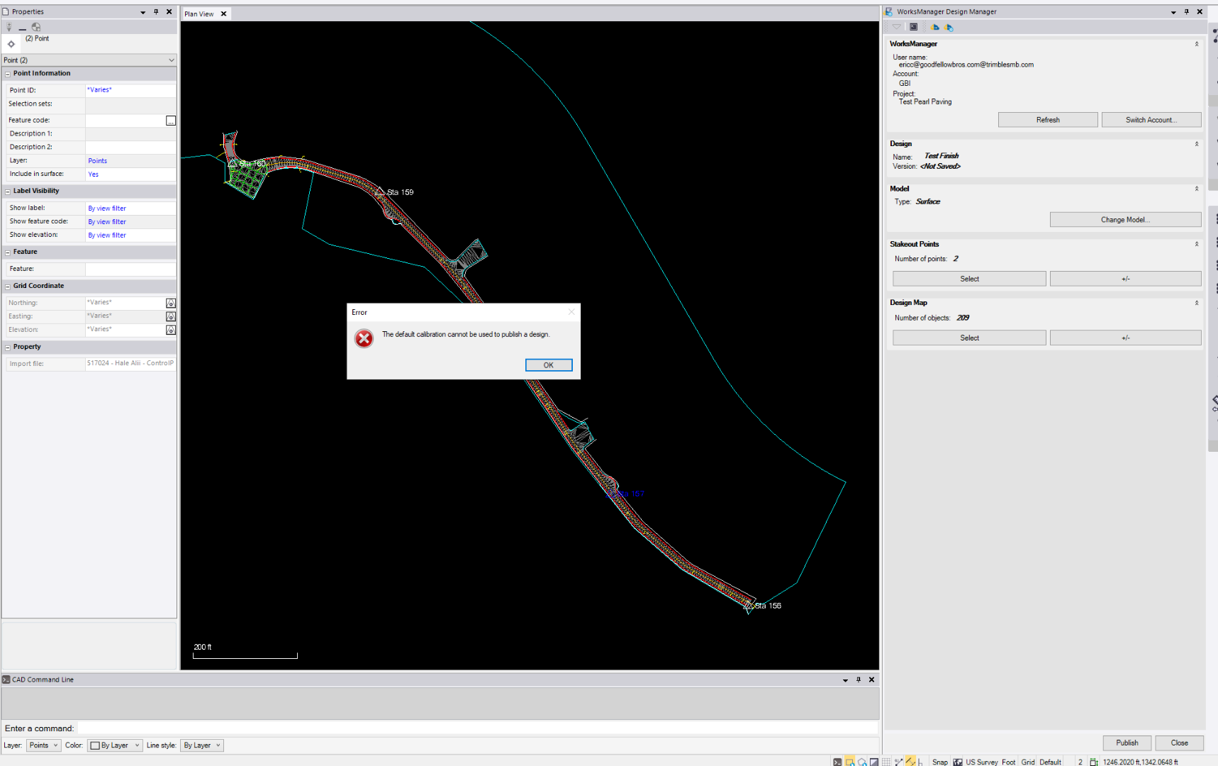

    Right now you need to have calibration in order to publish your design to WM. We tried it with one of Trimble guy and SITECH and you can't publish a design without a dc/cal. below
    We have projects that are covered with trees and they are saving all the trees incorporating to the design and using GPS is impossible, Can't use State Plane either because the coordinates were assumed (N=5000, E=5000 El=100). We also have smaller projects that do not need GPS and all staking was done using total stations.
    You can have both TCC and WM running. So all your projects with calibration can be place in the WM and the one without is to TCC. The problem is the field guys who move from one project to another have to change the account every time they do the syncing from TCC to WM in their data collector.
    As long as they extend our TCC account until the WM is fully ready for us, we good for staying in TCC.
