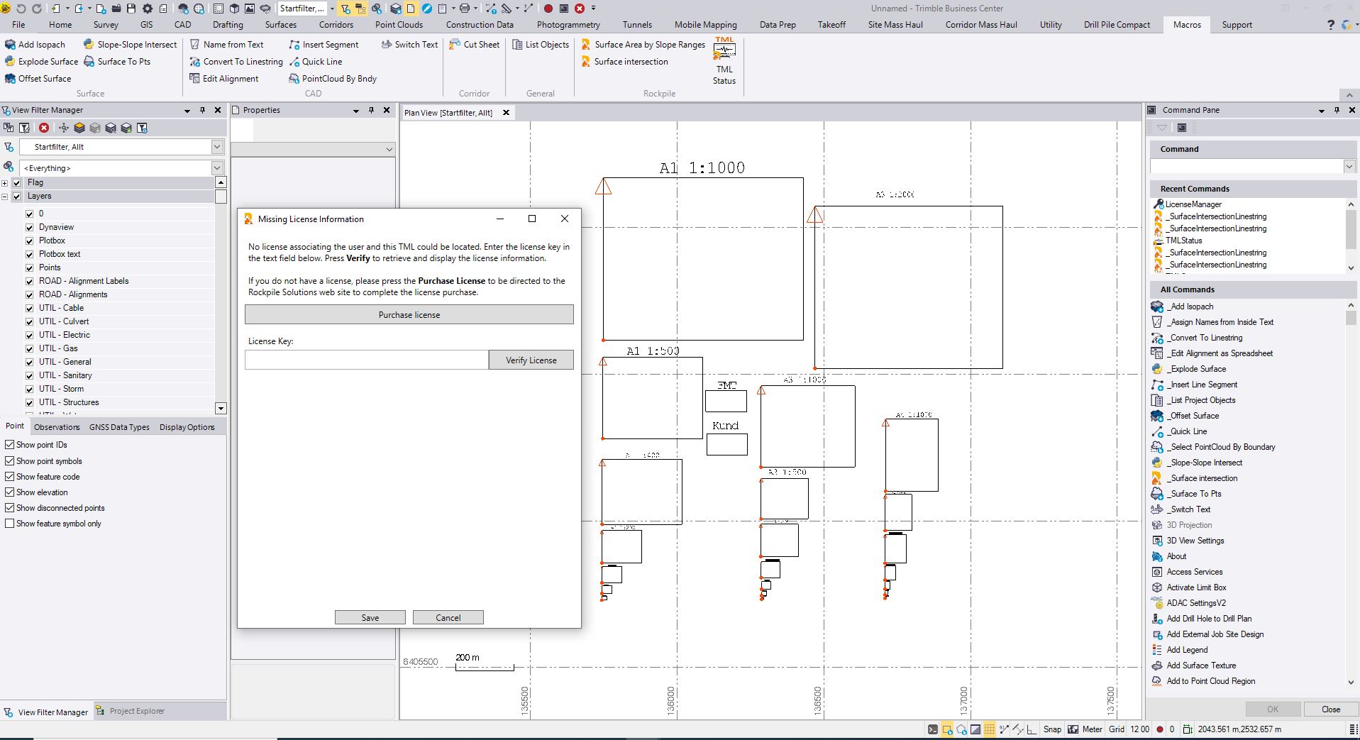

    Anyone else that have trouble with macros after installing 5.3? We are 2 different users that have the same problem after updating. It crashes and not working.
  • 2.  Re: Macros not working in 5.3
    Posted 05-01-2020 01:48
    The latest TMLStatus is needed to run TBC 5.30.  The 5.30 version modified some of the APIs used by by the Rockpile Solutions TMLs.  One of biggest differences is how the Trimble ID is managed. Be sure to create / update your Trimble ID profiles in Support -> External Services - Profiles
  • 3.  Re: Macros not working in 5.3
    Posted 05-01-2020 12:06
    Thanks! I did reinstall TML and now it works, that was the problem.
    Do you know if i need to buy the "surface intersection" function to make it work or should it be included in TBC 5.3? It does not seem like it..
