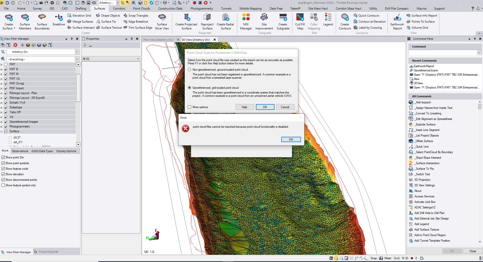

    And now i only get this.....

    The LAS files can be stored with the Project Folder - that is a setting that you want to copy the files to the Project file or not - That can be found under Support - Options - Point Clouds and is a check box that says
    The second thing that says Point Cloud Functionality has been disabled - Check your license information in Support License Manager - maybe you lost connection to your Security Key / Network License and therefore don't have a License to run the Point Cloud stuff active or something like that. Failing that I would reboot and see if that clears the issue. Let me know if either of these work / don't work - I may have to get the Techs on this one as I have never seen that message personally
    I cannot tell you why the Point Clouds disappeared from the project - that looks to me like the Project lost connection to the SDE Database used for the Point Clouds for the project - I cannot tell you how that happened
    Let me know if you can recover the functionality or not, and I will discuss with the Techs on Monday am.

    This is what i now have tried and it dont work:
    • Rebooting.Still 0 points in the imported files TBC says.
    • I opened another project with pointcloud (almost every project we have includes pointclouds) and it works.
    • I started a new project and drag n dropped a pointcloud to import and it works without any problems. The license should be working.
    • Tried to import the same pointcloud file again in the project but it says the same, -the piontcloud functionality is disabled.
    I will share this project to you Also by e-mail. Have a nice sunday!
