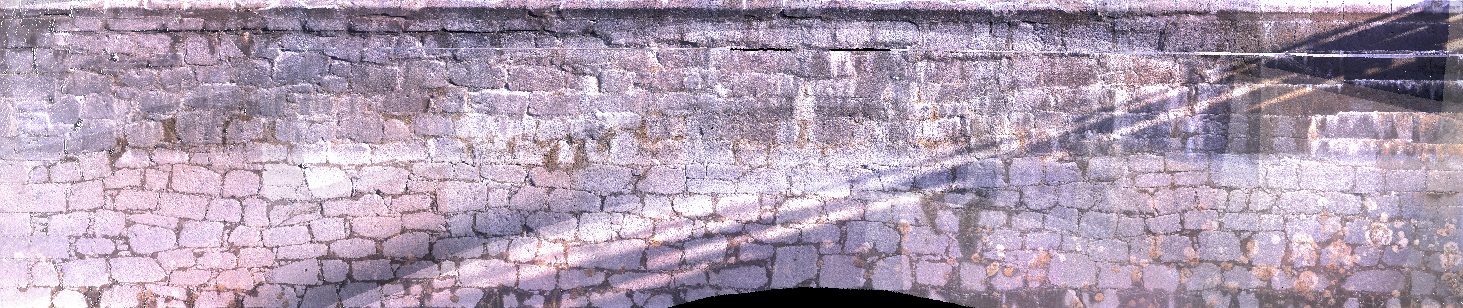

    Hi!
    I really need a way to place some kind of picture in my drawings where i have a cut n fill map for a wall. We have scanned the wall with a SX10 and to do my presentation more understandable i need some kind of photo on that box. I would like to see the pointcloud there but that does not seem to work in TBC so i tried to make a orthophoto intstead from my pointclud. The problem is that the photo hets totally black but if i zoom in i can see the pointcloud kind of hires or it gets totally white. I have tried to make it with true colours, grey scale, depth and so on but nothing works. I have used a setting of 0.001 in resolution, maybe thats the problem?

    Solved! My bad, 1mm resolution does make it really bad. In my case it had to be 2cm pixels and the it looked really good.
