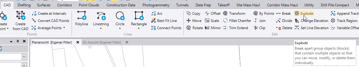

    It seems like the table is still like a CAD-Blockreference. Did you try to explode it in to lines and Text?
    After that you should be able to select it like your used to it with Select Similar or my favorite Advanced Select.
    Let me know if it helps!
