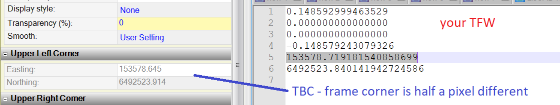

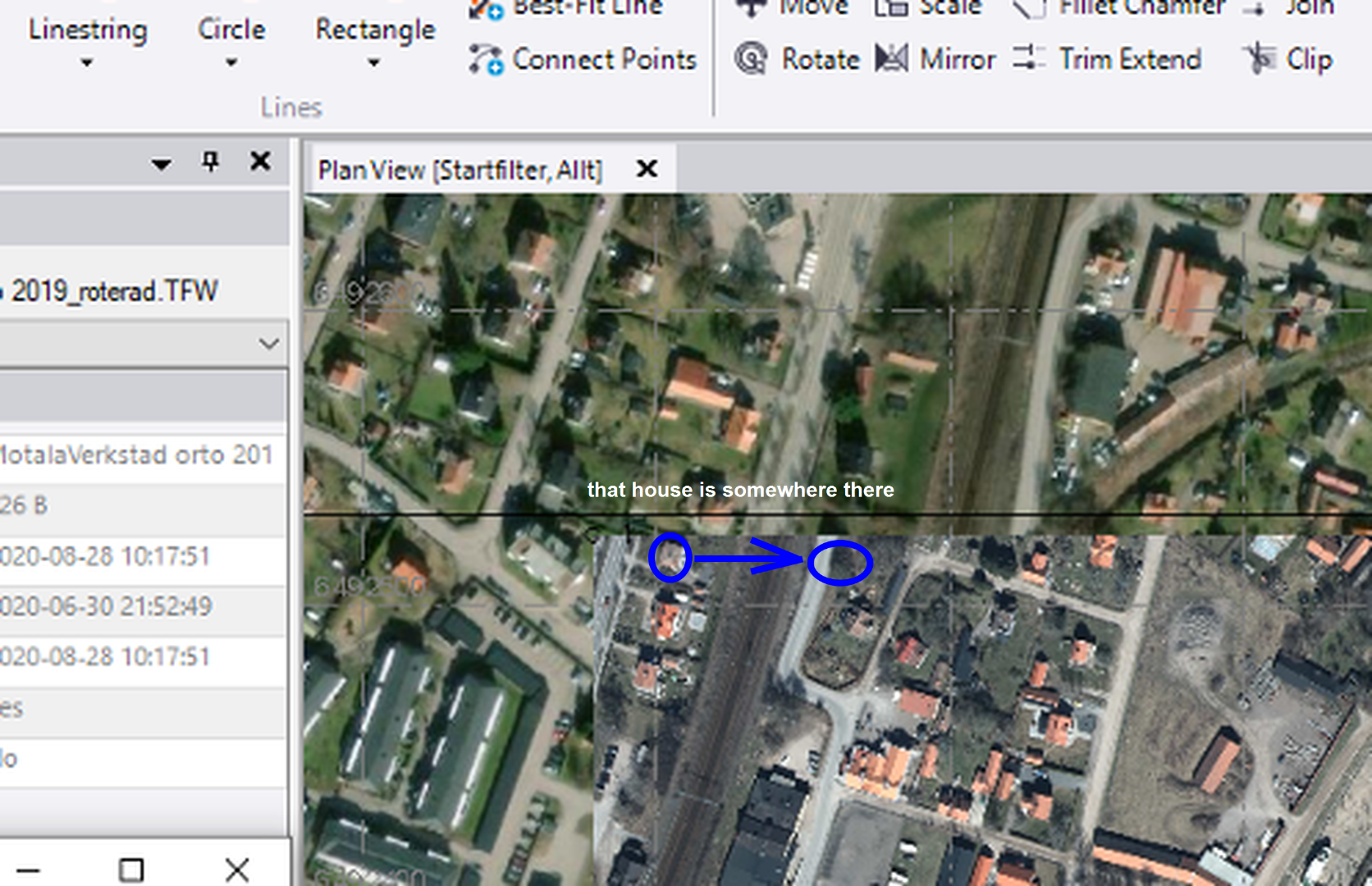

    I did some more testing with this.
    Just importing the pdf does not work but if i open the pdf in Adobe and export it as a .tiff and then import the .tiff in TBC the picture will be imported and the top left corner will match my point with the coordinates from the .tfw file. TBC does use the .tfw file when importing the .tiff but the scale is not correct. The file is also rotated wrong but that could be fixed in Adobe but the scale is still wrong. The info in the tfw file says the pixel size is 0.148592999463529 (i think) but i dont know how to use that in TBC.
  • 6.  Re: PDF Orthophoto, how to import?
    Posted 08-29-2020 00:10
    My initial comment below was premature, if you'd been able to export the original image from the PDF, the one that matches the pixel size in the TFW you only would have to drag 'n drop it into TBC. Obviously your exported image doesn't match the pixel dimensions from the TFW anymore. Give the attached TIFF a try, I opened the PDF in Photoshop and saved it as TIFF, maybe it is different to yours. Since I don't know what coordinate system you are using I can't test it.
    The TFW unfortunately only contains one coordinate, if the image doesn't fit the pixel size of the TFW anymore the image will be scaled the wrong way. That's what you are seeing.
    There would be no way to fix that, unless you have a second coordinate of a distinct feature in the image.

    So, you have to use the pixel dimensions from your TIFF, lets assume your image is 2000 pixel wide and 3000 pixel high.
    Then the lower right corner would be
    Easting = 153578.7192 + 0.148592999463529 * 2000 and
    Northing = 6492523.8401 + -0.148579243079326 * 3000.
    Be aware that this is for the center of the pixel. Depending on how accurate you need it, you might want to offset your two corners by an additional half pixel, since you can only snap to the corner of the image frame.

    But I wouldn't be so sure that the image is in the right spot in AutoCad. Not with additional linework or background imagery visible. The coordinate system in the bottom left corner of AutoCad doesn't seem to be rotated, but the image is. It could be a UCS though. The view center in AutoCAD is shown at 141627, 6485896 the background imagery in your TBC screenshot on the other hand is at about 153850, 6492350. That is >12 km different. That raises question marks.
    And according to your screenshot and what I found on Google Earth the image needs to be rotated 90 degrees to the right.
    Furthermore, the TFW doesn't contain any rotation values. And what I missed in your screenshot first, not even the top left corner seems to be in the correct position in TBC. I enlarged the screen shot and compared in Google Earth.
    So the TFW doesn't seem to be related to the image at all. Position and scale factor/pixel size don't fit together.
    If they can provide you with the two coordinates for the top left/bottom right corner from AutoCad you can easily reference it in TBC, but without you can only guess.
    Unless somebody here has a way to extract more info from the PDF.
