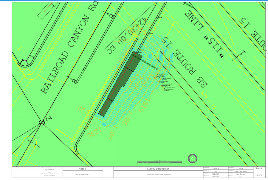

       I am having similar issues,  and adding, ortho's as background images are not working as intended. I am getting a solid, green color background where the ortho would have worked/existed in 5.30.

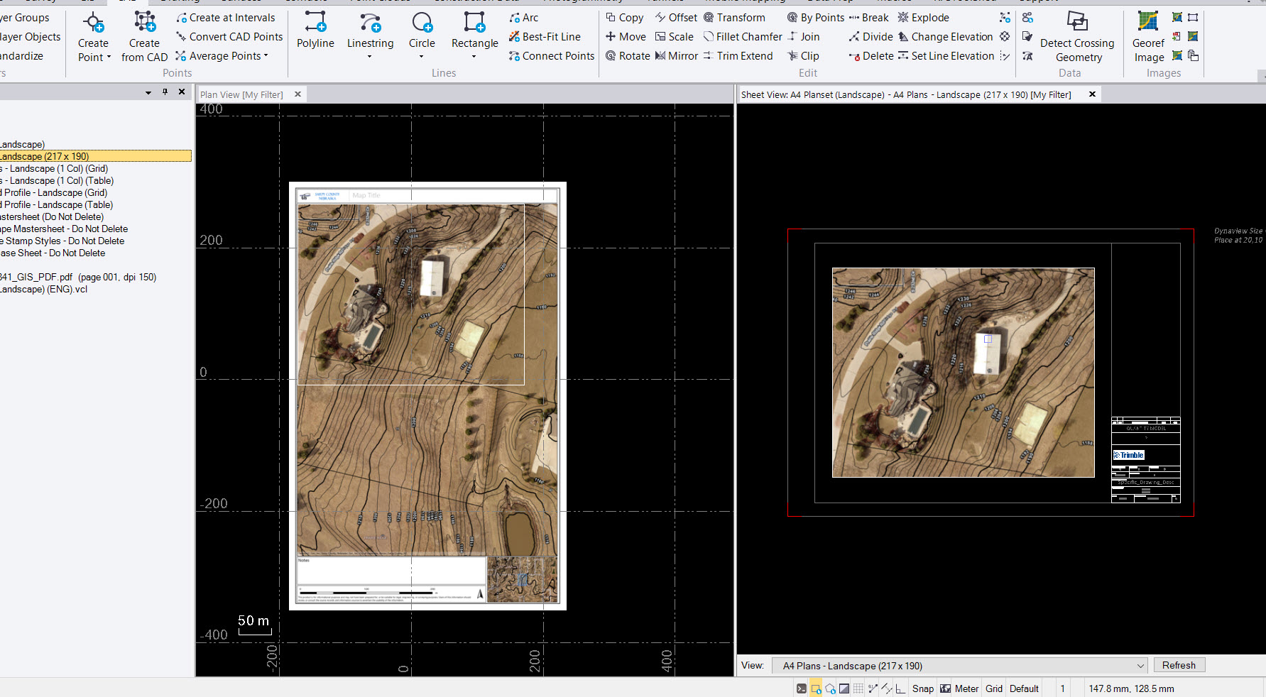

    @Fredrik Bergstrom @Andy Deveney I am not seeing this issue with my test data set. See image below. Is there anything I am missing with my data set? Can you share yours so that we can reproduce and investigate?

    Posted 08-05-2020 11:52
    Hi Adam and thank you for the response.,
       This issue is when you print your sheet to pdf to disseminate.
    See below

    Andy's issue is being looked at but his is a pure plotting issue that generates a Green Box in the PDF output. The team have looked at that and have now recreated the problem and it appears that it is an issue with printing large images to PDF - his file showed the issue and the dev team can work on it as a result. There is an update due out shortly for some other things that are going on so this will be an update that goes in that release hopefully.
