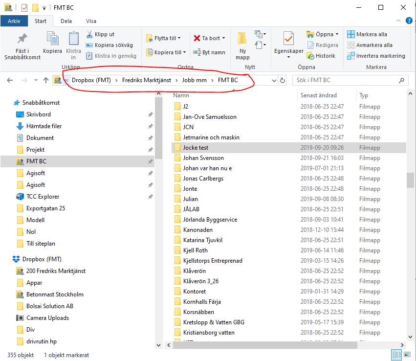

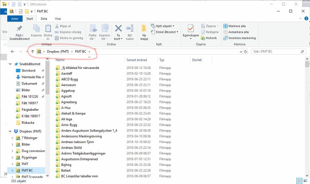

    @Alan Sharp Can you show this to Geospatial Team also, im about to be nuts here.....Here is a video Recording #156 - YouTube  and here is what ive done (also expalining in the video)
    Because we think that dropbox is the problem (wich it is in some cases) i did stop my dropbox sync on my computer. I took my portable harddrive to my colleague because in his computer the project works fine (and on all other computers, its just mine that dont). He had stopped his sync and we opend the project and saved it, no problem at all. We copied the project with all files and folder to my portable harddrive and i went to my computer to test it. I started with opening it from the harddrive, success!!. It worked like it should.
    I deleted the whole project folder on my computer (dropbox still off of course) and copied the project and folder from the portable harddrive to my computer. Started the project from my harddrive and it was still the same, corrupted files..........HELP!!
    I tride to move the project up in the hierarcy (if it to many folders) but that did not help either. And i have many other projects with pointclouds wich works just fine in the same location. And bigger projects also. I also tried to use "save as" with the project from the harddrive and saved it to my computer but when i open it again i get the same errors "corrupted files"...
    I really have no idea right now.
    One thing i know work is if i delete the database files and folder and import the pointclouds again the problem goes away. But then i have to classify them again. I have done that once in this problem but the problem occured when the project had been opened in another computer. And its just some projects that is like this but this is the biggest problem i have had, the problem has been fixing it self most of the time in other projects.
    Have a nice day.

  • 13.  Re: Pointcloud error, somtimes before and now almost every time.
    Posted 09-18-2019 22:10
    @Alan Sharp or @Tim McClannahan have you heard anything about this or have any ideas? Please look at the videos, its not Dropbox causing the problems in this cases, it something that is different when i start the project in different computers.
    Have you seen this problem anywhere else or is it just me?
  • 14.  Re: Pointcloud error, somtimes before and now almost every time.
    Posted 09-18-2019 23:18
    Are you copying the entire folder system and the VCE file over to the new PC ie the project folder and all its sub folders
    You have to also be aware of the path names length when you copy and paste the folder system - windows lets you create longer path names than legally allowed by windows so when you copy and paste a folder system some folders and files get left off. You have to copy the entire folder system because the point Clouds are not in the VCE they are stored in an external database in one of the folders for the project.
    Sent from my iPhone
  • 15.  Re: Pointcloud error, somtimes before and now almost every time.
    Posted 09-20-2019 03:37
    Hi!
    Again, thank you so much for your answers. As always you are right again, its the path names length that is the problem. I was sure that all 4 of us in the office had the folder at the same location but that was not the case. (see the screenshots, the top is my computer and the bottom is Magnus) I had my folder under 2 other folders after "dropbox", and the 3 other guys had the folder directly under "dropbox".
    When i moved the folder up the project that did not open before and just said i had a pointcloud error opened without any problems.
    But......the one thing that i cant understand is that if Magnus has saved a project with his computer i never got the problem when i opened it but if one of the other 2 guys did the same in their computers the problem occured.
    So, i think we can close this issue now, i hope so.
    Have a nice day!
  • 16.  Re: Pointcloud error, somtimes before and now almost every time.
    Posted 09-21-2019 15:20
    If the default folder is \documents\ etc then the pre path to that for Magnus may be shorter than your other colleagues if the username \ Computername is shorter - just one or two characters could make the difference - if all your pcs have names like Office1 or Office2 then that would not be the case but if it uses a combination of first name / Last name etc then they will likely be different
    Would have to see the full path names to see whether this is the case or not
    Sent from my iPhone
